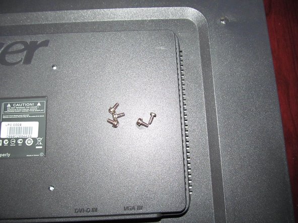

    • Sort this screw separately, as it is unique.
    • Remove 4 fine threaded screws from the back of the monitor with a Phillips #0 screwdriver. All of these screws are the same.

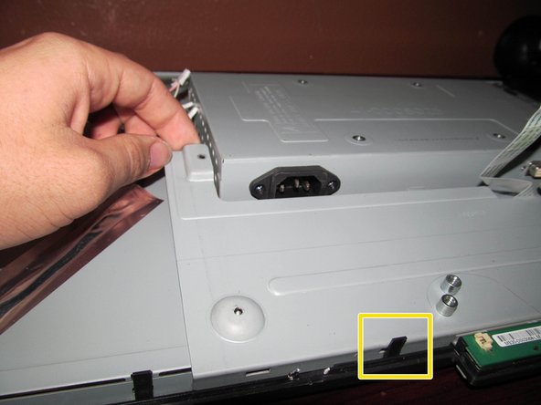

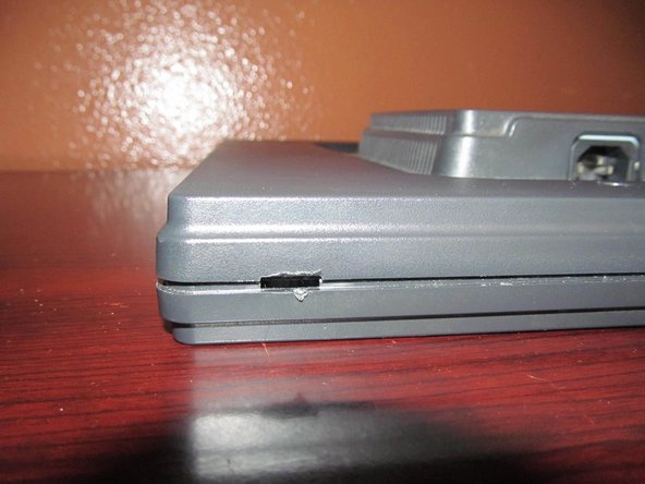

  5. Acer AL2216W Capacitor Replacement, Unlatch the clips (Bottom): crwdns2935265:05crwdnd2935265:01crwdnd2935265:02crwdne2935265:0 Acer AL2216W Capacitor Replacement, Unlatch the clips (Bottom): crwdns2935265:05crwdnd2935265:02crwdnd2935265:02crwdne2935265:0
    Jimmy
    $7.95
    • If the monitor has never been serviced, you may have to use a flathead screwdriver, Jimmy or a Heavy duty spudger. This will damage the plastic somewhat and is unavoidable. In some cases, you may be able to use a plastic pry tool instead of metal to avoid the damage, but not every time.
    • Open the monitor at the bottom of the monitor by releasing the four tabs with a flathead screwdriver or a Jimmy and plastic pry tool. If force is needed, the best way to do this is to put electrical tape on a flathead screwdriver and split the panels.

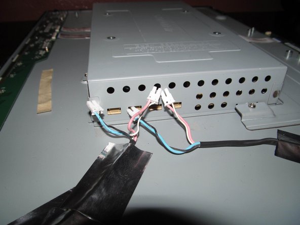

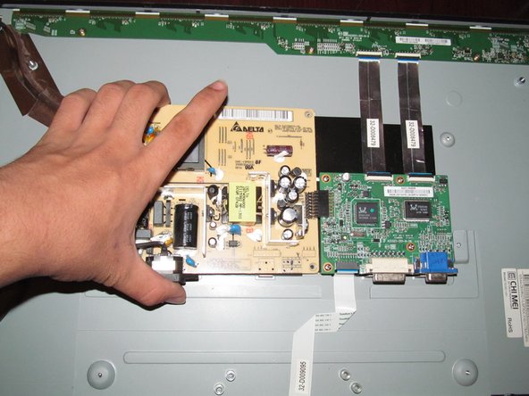

  9. Acer AL2216W Capacitor Replacement, Disconnect the backlight cables: crwdns2935265:09crwdnd2935265:01crwdnd2935265:02crwdne2935265:0 Acer AL2216W Capacitor Replacement, Disconnect the backlight cables: crwdns2935265:09crwdnd2935265:02crwdnd2935265:02crwdne2935265:0
    • Disconnect the CCFL cables from the power supply board.

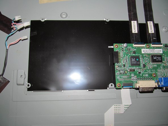

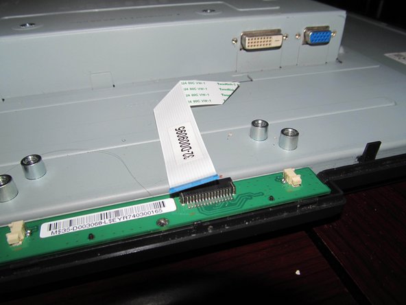

  10. Acer AL2216W Capacitor Replacement, Disconnect the button board: crwdns2935265:010crwdnd2935265:01crwdnd2935265:02crwdne2935265:0 Acer AL2216W Capacitor Replacement, Disconnect the button board: crwdns2935265:010crwdnd2935265:02crwdnd2935265:02crwdne2935265:0
    • Board removal is optional.
    • Disconnect the flat flex cable that goes to the control board.

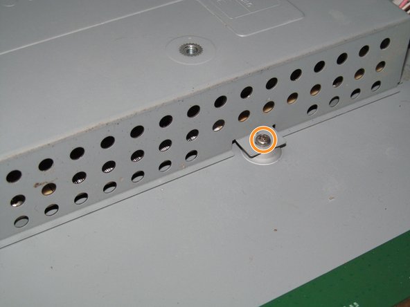

  11. Acer AL2216W Capacitor Replacement, Remove the power supply shield (Part 1): crwdns2935265:011crwdnd2935265:01crwdnd2935265:02crwdne2935265:0 Acer AL2216W Capacitor Replacement, Remove the power supply shield (Part 1): crwdns2935265:011crwdnd2935265:02crwdnd2935265:02crwdne2935265:0
    • EET owners: Your kit has this bit. No purchase needed.
    • Remove the 2 lower screws that hold the power supply shield to the monitor with a Phillips #0 screwdriver.

  13. Acer AL2216W Capacitor Replacement, Remove the power supply: crwdns2935265:013crwdnd2935265:01crwdnd2935265:03crwdne2935265:0 Acer AL2216W Capacitor Replacement, Remove the power supply: crwdns2935265:013crwdnd2935265:02crwdnd2935265:03crwdne2935265:0 Acer AL2216W Capacitor Replacement, Remove the power supply: crwdns2935265:013crwdnd2935265:03crwdnd2935265:03crwdne2935265:0
    • IF YOU ARE REPLACING THE FILTER CAPACITOR, IT MUST BE DISCHARGED BEFORE REMOVAL FOR SAFETY!
    • The black screw is a ground screw and must be placed in the same location when reassembling the monitor. The remaining 3 screws can be installed in any order when reinstalling the power supply.
    • Any bulged capacitors are likely to have a residual charge, and the power supply should be handed with this assumption in mind if you see any visibly bulged capacitors.
    • With the power supply shield removed from the monitor, identify the power supply. Take note of the printed values, including the inverter cap (if present).
    • Remove the 4 Phillips #1 screws from the power supply. Once this is done, lift up the power supply at a slight angle to clear the chassis. Do not lift too much or the connector may be damaged!
    • This capacitor is only found on older power supplies. Replacement is optional, but recommended.

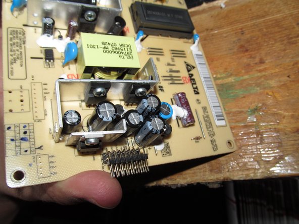

  14. Acer AL2216W Capacitor Replacement, (Optional) Capacitor polarity marking: crwdns2935265:014crwdnd2935265:01crwdnd2935265:01crwdne2935265:0
    • If the PCB is marked to avoid mis-installation, the flux will wash these marks off.
    • If you are unsure of the position of the capacitors, mark the polarity with a permanent marker. If the capacitors are incorrectly installed, they will explode when power is applied.

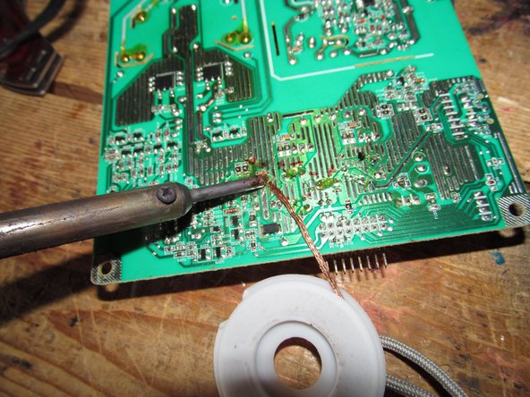

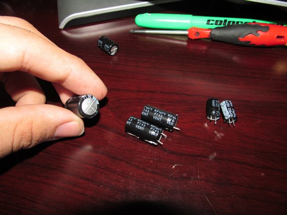

  16. Acer AL2216W Capacitor Replacement, Remove the old capacitors: crwdns2935265:016crwdnd2935265:01crwdnd2935265:03crwdne2935265:0 Acer AL2216W Capacitor Replacement, Remove the old capacitors: crwdns2935265:016crwdnd2935265:02crwdnd2935265:03crwdne2935265:0 Acer AL2216W Capacitor Replacement, Remove the old capacitors: crwdns2935265:016crwdnd2935265:03crwdnd2935265:03crwdne2935265:0
    • Use of a Helping Hands is recommended to avoid soldering iron contact. If you do not have one, hold the board at an angle.
    • While a partial replacement may work, the remaining capacitors will fail. It is best to do them all while servicing the failed ones. Refer to this guide for a soldering "how to".
    • Move to a workspace with ventilation or use a fume extractor. Once in an appropriate workspace, desolder the old capacitors. Heat up each leg and remove it.
    • After removing the capacitors, clean up the old solder with a desoldering braid. Lift it with the iron when removing it.
  17. Acer AL2216W Capacitor Replacement, Installing brand new capacitors: crwdns2935265:017crwdnd2935265:01crwdnd2935265:01crwdne2935265:0
    • Check the capacitor polarity before soldering the new capacitors in. Incorrectly installed capacitors will explode with power applied!
    • Install the new capacitors. Check the polarity and bend the leads so they do not come loose during installation.
  18. Acer AL2216W Capacitor Replacement, Solder the new capacitors in: crwdns2935265:018crwdnd2935265:01crwdnd2935265:03crwdne2935265:0 Acer AL2216W Capacitor Replacement, Solder the new capacitors in: crwdns2935265:018crwdnd2935265:02crwdnd2935265:03crwdne2935265:0 Acer AL2216W Capacitor Replacement, Solder the new capacitors in: crwdns2935265:018crwdnd2935265:03crwdnd2935265:03crwdne2935265:0
    • Once the polarity is verified, solder the capacitors in. After installation, cut off any excess lead.

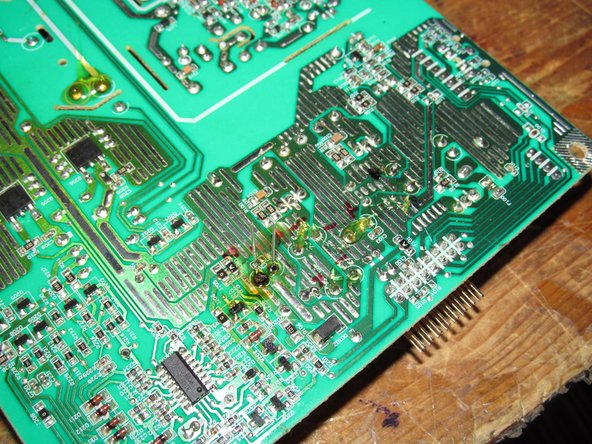

I did not replace the large capacitor on the Acer monitor yet. All other caps have been replaced. I may have to replace the FSPO55- ZP102A as it has a hot spot beside it. I don't know if the part number is right? Do know where I can buy it. Tom B
Thomas Brady - crwdns2934203:0crwdne2934203:0
These older CCFL panels usually burn on the PCB by the inverter coil and main transformer (the Delta branded part, in this case). The LED monitors limit the failure points to the transformer.
It sounds like your PCB got burned from the heat by the transformer or the inverter coil. This is very common and the boards are designed to take it. However, if you are concerned you should buy a new power supply board altogether if that makes you more comfortable.
