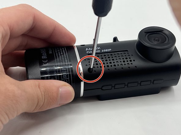

  2. Abask J05 Front Case Replacement: crwdns2935265:02crwdnd2935265:01crwdnd2935265:01crwdne2935265:0
    • Remove the 5 mm screw from the side of the device next to the suction cup dock with a Phillips #00 screwdriver.
