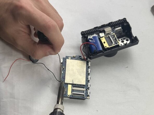

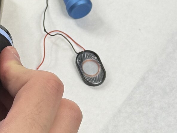

  10. Abask A8 Speaker Replacement, Speaker: crwdns2935265:010crwdnd2935265:01crwdnd2935265:03crwdne2935265:0 Abask A8 Speaker Replacement, Speaker: crwdns2935265:010crwdnd2935265:02crwdnd2935265:03crwdne2935265:0 Abask A8 Speaker Replacement, Speaker: crwdns2935265:010crwdnd2935265:03crwdnd2935265:03crwdne2935265:0
    • Removing the photodiode will expose the speaker, connected by wires.
    • Using a soldering iron, desolder the speaker connections from the motherboard.
