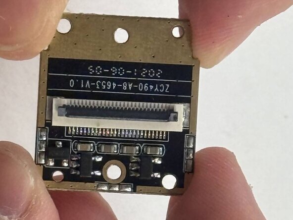

  8. Abask A8 Photodiode Replacement, Photodiode: crwdns2935265:08crwdnd2935265:01crwdnd2935265:01crwdne2935265:0
    • Gently release the silver locking flap that is holding the ribbon cable connecting the photodiode to the motherboard.
    • Carefully pull the flat ribbon cable out of the connector.
  9. Abask A8 Photodiode Replacement: crwdns2935265:09crwdnd2935265:01crwdnd2935265:02crwdne2935265:0 Abask A8 Photodiode Replacement: crwdns2935265:09crwdnd2935265:02crwdnd2935265:02crwdne2935265:0
    • Use a Phillips #00 screwdriver to remove the four 1.6 mm screws that secure the photodiode.
    • Carefully lift the old photodiode out of its base.
    • To avoid damaging the photodiode, make sure to place it face down on a clean, static-free surface when not handling it.
