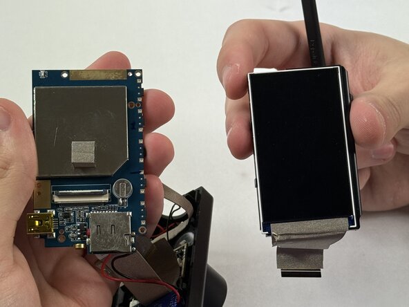

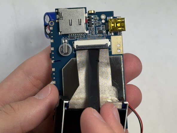

  6. Abask A8 Motherboard Replacement, Motherboard: crwdns2935265:06crwdnd2935265:01crwdnd2935265:02crwdne2935265:0 Abask A8 Motherboard Replacement, Motherboard: crwdns2935265:06crwdnd2935265:02crwdnd2935265:02crwdne2935265:0
    • Lift the ZIF locking flap that is securing the ribbon cable connecting the motherboard to the shell.
  7. Abask A8 Motherboard Replacement: crwdns2935265:07crwdnd2935265:01crwdnd2935265:02crwdne2935265:0 Abask A8 Motherboard Replacement: crwdns2935265:07crwdnd2935265:02crwdnd2935265:02crwdne2935265:0
    • Gently lift the ribbon cable locking flap and disconnect the ribbon cable from the motherboard.
    • Carefully separate the motherboard from the screen.
