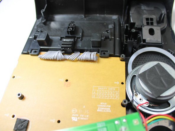

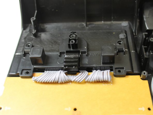

    3. ATT CL2940 Buttons and/or Keypad Replacement: crwdns2935265:03crwdnd2935265:01crwdnd2935265:01crwdne2935265:0
      • When setting the back panel down, be careful to not rip any of the wires off of the internal components.

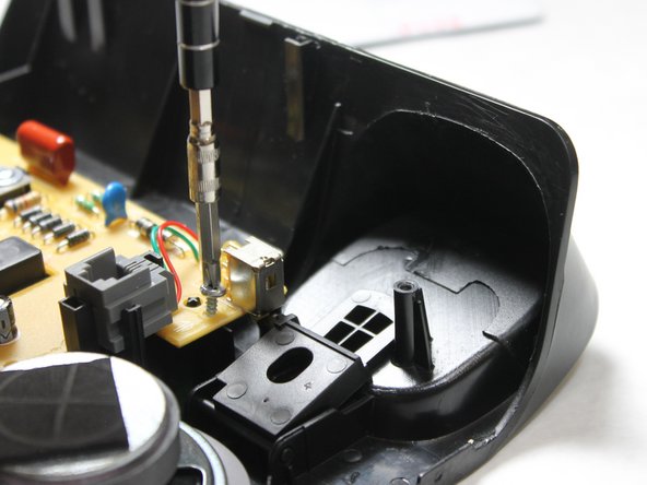

    1. ATT CL2940 Buttons and/or Keypad Replacement, Buttons and/or Keypad: crwdns2935265:04crwdnd2935265:01crwdnd2935265:02crwdne2935265:0 ATT CL2940 Buttons and/or Keypad Replacement, Buttons and/or Keypad: crwdns2935265:04crwdnd2935265:02crwdnd2935265:02crwdne2935265:0

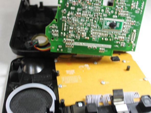

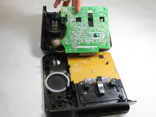

      • Unscrew five 5.6 mm screws on top level, yellow motherboard.
    2. ATT CL2940 Buttons and/or Keypad Replacement: crwdns2935265:05crwdnd2935265:01crwdnd2935265:03crwdne2935265:0 ATT CL2940 Buttons and/or Keypad Replacement: crwdns2935265:05crwdnd2935265:02crwdnd2935265:03crwdne2935265:0 ATT CL2940 Buttons and/or Keypad Replacement: crwdns2935265:05crwdnd2935265:03crwdnd2935265:03crwdne2935265:0
      • Lift the top level Motherboard in order to get to the lower level Motherboard.
    3. ATT CL2940 Buttons and/or Keypad Replacement: crwdns2935265:06crwdnd2935265:01crwdnd2935265:02crwdne2935265:0 ATT CL2940 Buttons and/or Keypad Replacement: crwdns2935265:06crwdnd2935265:02crwdnd2935265:02crwdne2935265:0
      • Unscrew the 5.6 mm screw on the clip behind the Screen as shown.
    4. ATT CL2940 Buttons and/or Keypad Replacement: crwdns2935265:07crwdnd2935265:01crwdnd2935265:02crwdne2935265:0 ATT CL2940 Buttons and/or Keypad Replacement: crwdns2935265:07crwdnd2935265:02crwdnd2935265:02crwdne2935265:0
      • Unscrew five 5.6 mm screws on the lower level Motherboard.
      • Keep the screws for the upper and lower level motherboard separated.
    5. ATT CL2940 Buttons and/or Keypad Replacement: crwdns2935265:08crwdnd2935265:01crwdnd2935265:02crwdne2935265:0 ATT CL2940 Buttons and/or Keypad Replacement: crwdns2935265:08crwdnd2935265:02crwdnd2935265:02crwdne2935265:0

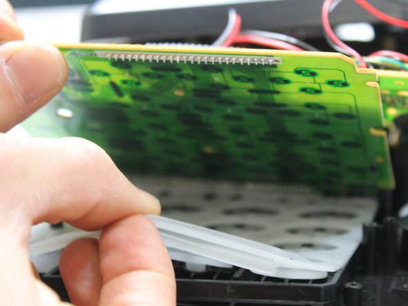

      • Lift the lower level Motherboard upward.
      • Remove the silicon pad above the buttons.
    6. ATT CL2940 Buttons and/or Keypad Replacement: crwdns2935265:09crwdnd2935265:01crwdnd2935265:02crwdne2935265:0 ATT CL2940 Buttons and/or Keypad Replacement: crwdns2935265:09crwdnd2935265:02crwdnd2935265:02crwdne2935265:0

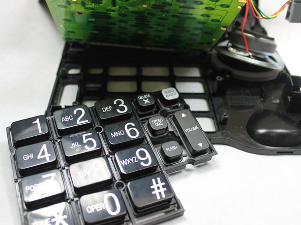

      • Push the Button Panel upward and pull it out.
      • Replace the entire Button Panel or a single defective button.
