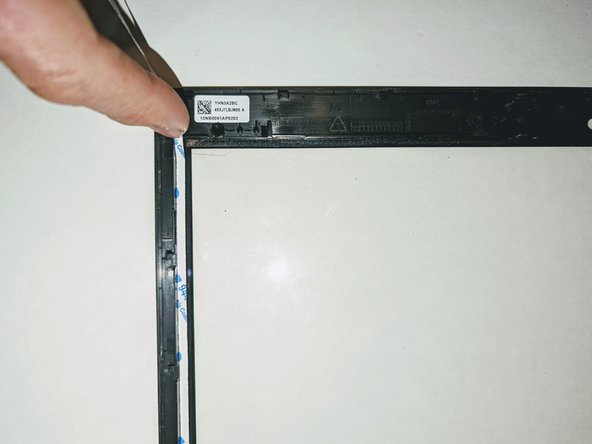

  1. ASUS VivoBook S400C LCD Adhesive Replacement, Remove the Old Adhesive Tape: crwdns2935265:01crwdnd2935265:01crwdnd2935265:03crwdne2935265:0 ASUS VivoBook S400C LCD Adhesive Replacement, Remove the Old Adhesive Tape: crwdns2935265:01crwdnd2935265:02crwdnd2935265:03crwdne2935265:0 ASUS VivoBook S400C LCD Adhesive Replacement, Remove the Old Adhesive Tape: crwdns2935265:01crwdnd2935265:03crwdnd2935265:03crwdne2935265:0

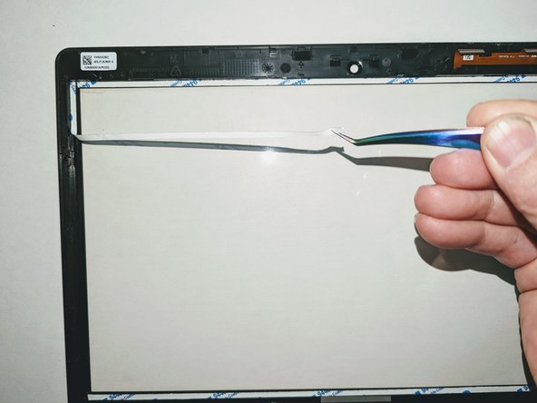

    • Skip this step if you're replacing the digitizer, unless you have a used touch screen and the adhesive tape is not usable.

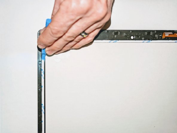

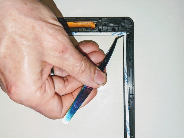

    • Peel up one end of an adhesive strip along the edge of the digitizer.
    • Grasp the freed end and pull it off the frame.

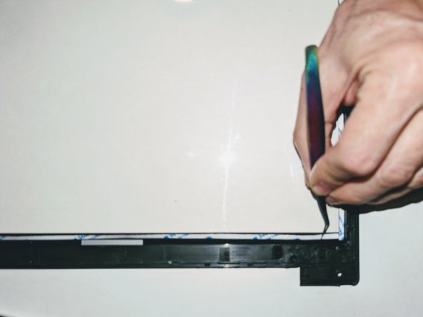

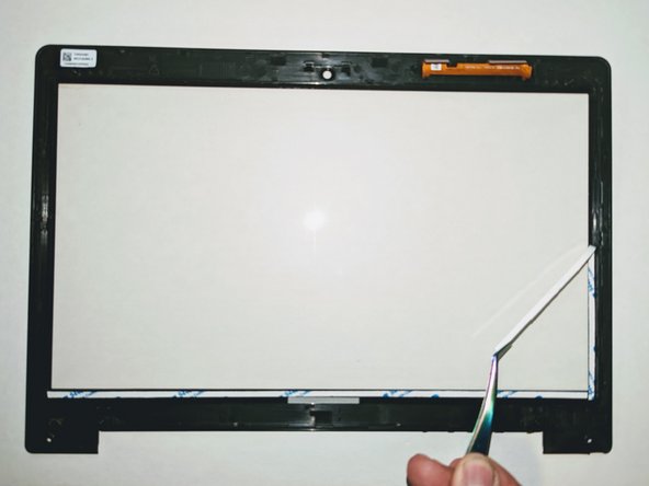

  2. ASUS VivoBook S400C LCD Adhesive Replacement: crwdns2935265:02crwdnd2935265:01crwdnd2935265:03crwdne2935265:0 ASUS VivoBook S400C LCD Adhesive Replacement: crwdns2935265:02crwdnd2935265:02crwdnd2935265:03crwdne2935265:0 ASUS VivoBook S400C LCD Adhesive Replacement: crwdns2935265:02crwdnd2935265:03crwdnd2935265:03crwdne2935265:0

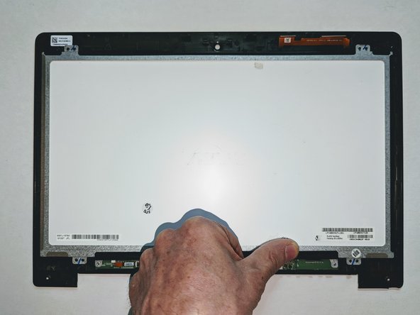

    • Repeat for the other three strips of adhesive tape.
    • If desired, you can clean any adhesive residue with acetone at this point.

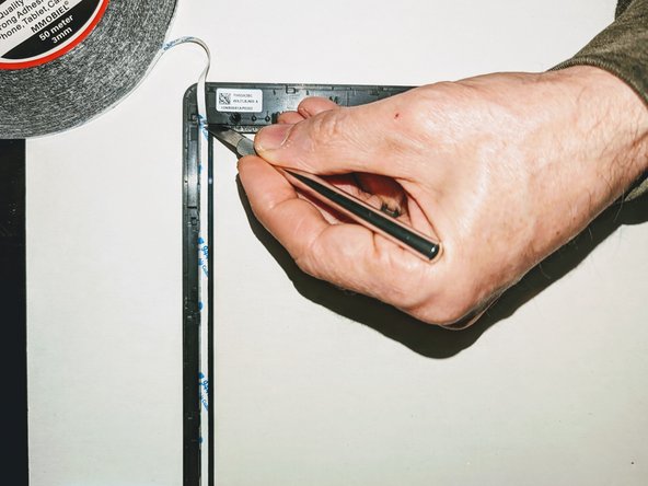

  3. ASUS VivoBook S400C LCD Adhesive Replacement, Lay Down New Adhesive Tape: crwdns2935265:03crwdnd2935265:01crwdnd2935265:03crwdne2935265:0 ASUS VivoBook S400C LCD Adhesive Replacement, Lay Down New Adhesive Tape: crwdns2935265:03crwdnd2935265:02crwdnd2935265:03crwdne2935265:0 ASUS VivoBook S400C LCD Adhesive Replacement, Lay Down New Adhesive Tape: crwdns2935265:03crwdnd2935265:03crwdnd2935265:03crwdne2935265:0

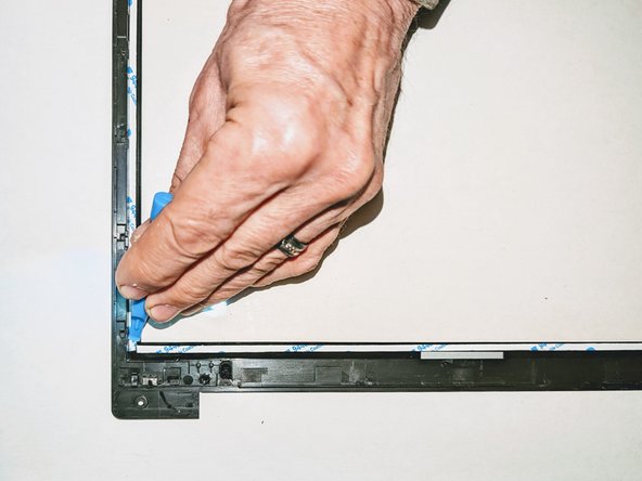

    • Unroll a length of 3mm double-sided tape long enough to cover the side being worked on.
    • Starting at the end, press it down onto the edge of the screen, outside of the transparent glass.
    • Using scissors or a sharp knife, cut the tape to length.
  4. ASUS VivoBook S400C LCD Adhesive Replacement: crwdns2935265:04crwdnd2935265:01crwdnd2935265:03crwdne2935265:0 ASUS VivoBook S400C LCD Adhesive Replacement: crwdns2935265:04crwdnd2935265:02crwdnd2935265:03crwdne2935265:0 ASUS VivoBook S400C LCD Adhesive Replacement: crwdns2935265:04crwdnd2935265:03crwdnd2935265:03crwdne2935265:0
    • Repeat for the other three sides.

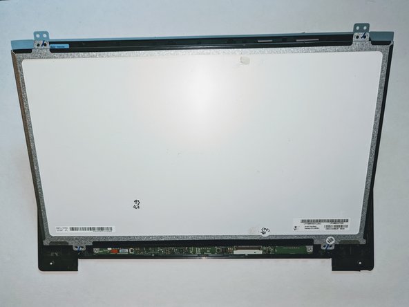

    • Remove the backing to expose the adhesive on all four edges.

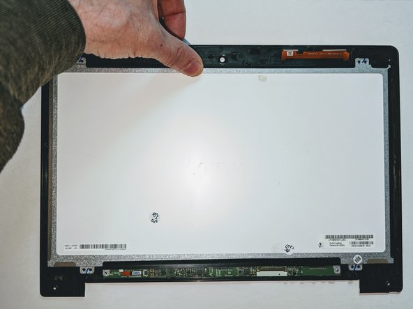

  7. ASUS VivoBook S400C LCD Adhesive Replacement, Secure the LCD to the Touch Screen: crwdns2935265:07crwdnd2935265:01crwdnd2935265:03crwdne2935265:0 ASUS VivoBook S400C LCD Adhesive Replacement, Secure the LCD to the Touch Screen: crwdns2935265:07crwdnd2935265:02crwdnd2935265:03crwdne2935265:0 ASUS VivoBook S400C LCD Adhesive Replacement, Secure the LCD to the Touch Screen: crwdns2935265:07crwdnd2935265:03crwdnd2935265:03crwdne2935265:0
    • Before you begin this step, now is a good time to thoroughly clean the LCD if needed, as you won't be able to once the LCD is glued to the touch screen. Any dirt or fingerprints left on the screen will be visible.
    • If you are reusing the LCD or have purchased a pre-owned replacement, you may want to use acetone to clean any adhesive residue from the frame.

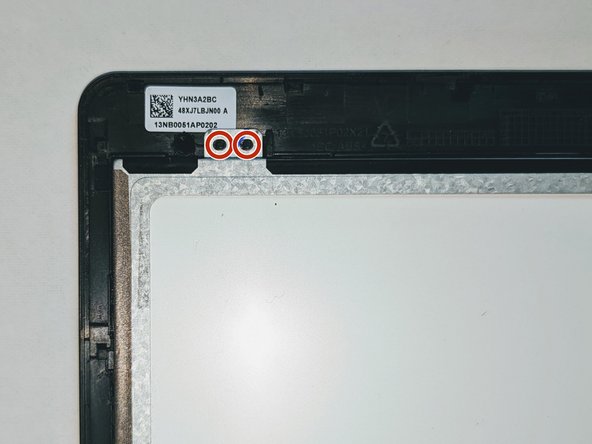

    • Position the LCD on the guide pins at the bottom of the screen, holding the top away from the adhesive so it doesn't adhere prematurely.
  8. ASUS VivoBook S400C LCD Adhesive Replacement: crwdns2935265:08crwdnd2935265:01crwdnd2935265:03crwdne2935265:0 ASUS VivoBook S400C LCD Adhesive Replacement: crwdns2935265:08crwdnd2935265:02crwdnd2935265:03crwdne2935265:0 ASUS VivoBook S400C LCD Adhesive Replacement: crwdns2935265:08crwdnd2935265:03crwdnd2935265:03crwdne2935265:0

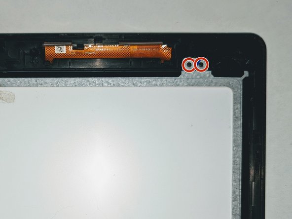

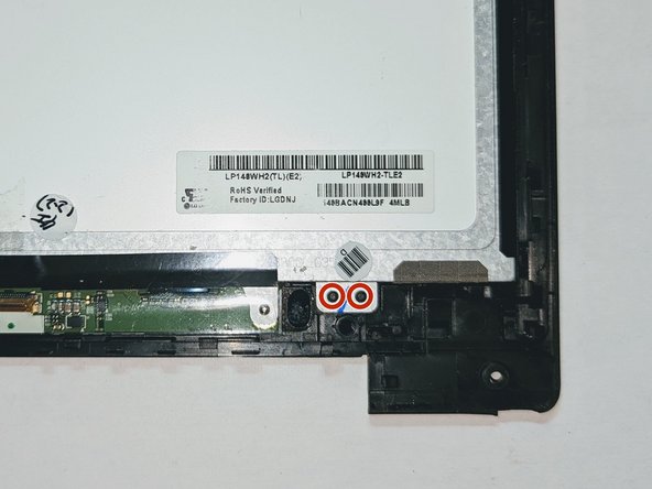

    • Lower the top of the LCD down onto the digitizer, making sure the upper guide pins are aligned.
  9. ASUS VivoBook S400C LCD Adhesive Replacement: crwdns2935265:09crwdnd2935265:01crwdnd2935265:03crwdne2935265:0 ASUS VivoBook S400C LCD Adhesive Replacement: crwdns2935265:09crwdnd2935265:02crwdnd2935265:03crwdne2935265:0 ASUS VivoBook S400C LCD Adhesive Replacement: crwdns2935265:09crwdnd2935265:03crwdnd2935265:03crwdne2935265:0
    • Press on the metal frame around the edge of the LCD to ensure it adheres to the digitizer.
