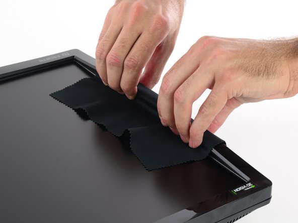

    • The display bezel is held to the rear case by plastic clips that can be released by pulling straight up on the bezel.
    • Rather than use any prying tools that could damage the LCD, it's best to just pull with your fingers. A thin cloth will both protect your fingertips and prevent you from smudging the LCD.
    • Lay the cloth over one of the long edges of the display.
    • Grip the side of the bezel through the cloth and lift straight up. A few clips in the center will pop free.
    • Be careful to pull straight up, and not pry against the display. Pushing down on the display could damage it.
