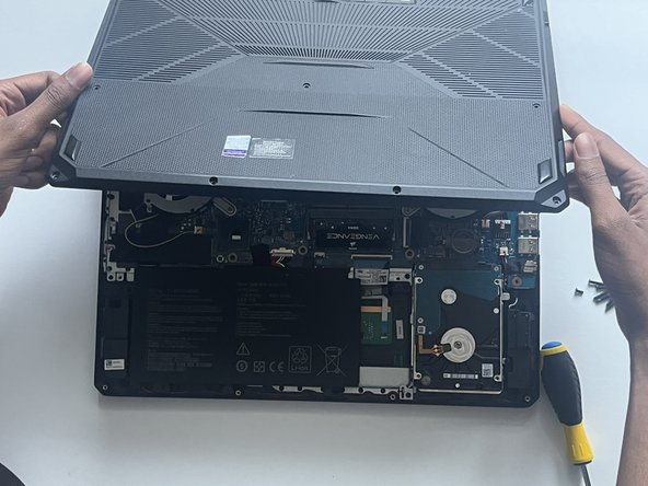

    • Gently flip the laptop so the bottom is facing up.
    • Use a Phillips #1 screwdriver to remove the six 14 mm screws found on the bottom and the left and right sides of the laptop.
    • Remove the five 7 mm PH1 screws found on the top and middle of your device.
  3. ASUS TUF Gaming FX505GT Battery Replacement: crwdns2935265:03crwdnd2935265:01crwdnd2935265:02crwdne2935265:0 ASUS TUF Gaming FX505GT Battery Replacement: crwdns2935265:03crwdnd2935265:02crwdnd2935265:02crwdne2935265:0
    • Use a spudger to pry the back panel from the laptop.
    • Work around the perimeter between the back case and the base, releasing any clips as you go.
    • Remove the back cover.

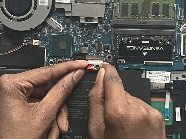

    • Use the point of a spudger to push on alternating sides of the battery connector to "walk" it out of its socket.

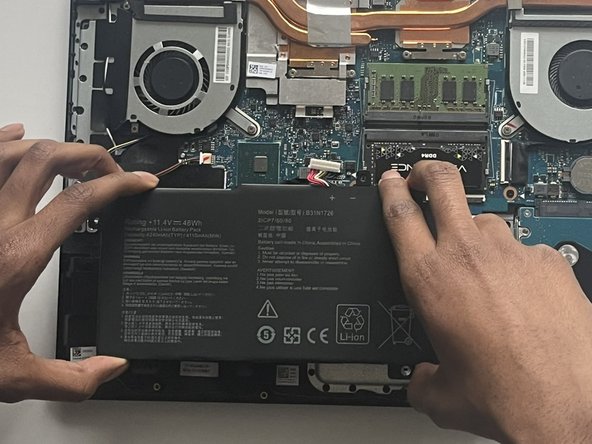

    • Use a Phillips #1 screwdriver to remove the 7 mm screw securing the battery.
    • Carefully lift the battery out of the laptop.
