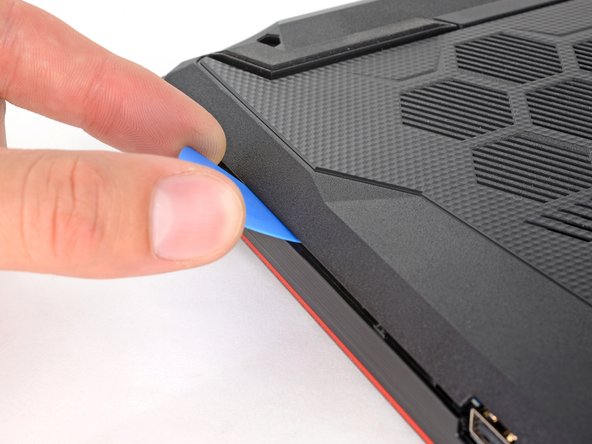

  2. ASUS TUF Gaming F15 FX506L Back Cover Replacement, Release the clips: crwdns2935265:02crwdnd2935265:01crwdnd2935265:02crwdne2935265:0 ASUS TUF Gaming F15 FX506L Back Cover Replacement, Release the clips: crwdns2935265:02crwdnd2935265:02crwdnd2935265:02crwdne2935265:0
    • Insert an opening pick between the bottom-right corner of the back cover and the chassis, near the captive screw.
    • Pry up to release the clips securing the back cover.
    • You'll hear a click whenever a clip is released.

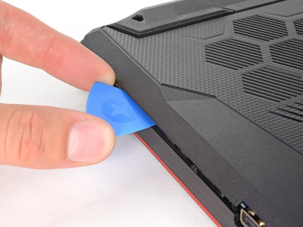

  3. ASUS TUF Gaming F15 FX506L Back Cover Replacement, Release the remaining clips: crwdns2935265:03crwdnd2935265:01crwdnd2935265:03crwdne2935265:0 ASUS TUF Gaming F15 FX506L Back Cover Replacement, Release the remaining clips: crwdns2935265:03crwdnd2935265:02crwdnd2935265:03crwdne2935265:0 ASUS TUF Gaming F15 FX506L Back Cover Replacement, Release the remaining clips: crwdns2935265:03crwdnd2935265:03crwdnd2935265:03crwdne2935265:0
    • Insert your opening pick again between the top-left corner of the back cover and the chassis.
    • Insert the pick at a steep angle. Pry up to release the remaining clips securing the back cover.
