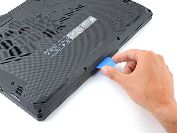

  2. ASUS TUF Gaming F15 FX506HEB-DB74 Left SSD Replacement, Insert an opening pick: crwdns2935265:02crwdnd2935265:01crwdnd2935265:02crwdne2935265:0 ASUS TUF Gaming F15 FX506HEB-DB74 Left SSD Replacement, Insert an opening pick: crwdns2935265:02crwdnd2935265:02crwdnd2935265:02crwdne2935265:0
    • Insert an opening pick between the lower case and the chassis on the front right edge.

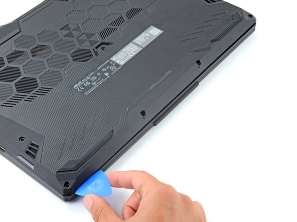

  3. ASUS TUF Gaming F15 FX506HEB-DB74 Left SSD Replacement, Release the right edge clips: crwdns2935265:03crwdnd2935265:01crwdnd2935265:02crwdne2935265:0 ASUS TUF Gaming F15 FX506HEB-DB74 Left SSD Replacement, Release the right edge clips: crwdns2935265:03crwdnd2935265:02crwdnd2935265:02crwdne2935265:0
    • Slide the pick along the right edge to release the clips securing the lower case.
