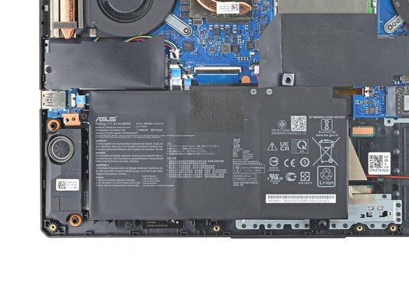

  6. ASUS TUF Gaming F15 FX506HEB-DB74 Battery Replacement, Reposition the plastic: crwdns2935265:06crwdnd2935265:01crwdnd2935265:02crwdne2935265:0 ASUS TUF Gaming F15 FX506HEB-DB74 Battery Replacement, Reposition the plastic: crwdns2935265:06crwdnd2935265:02crwdnd2935265:02crwdne2935265:0
    • Use your fingers to move the plastic that covers the battery connector out of the way.
    • If the plastic is not staying out of the way use a piece of tape to secure it.
  7. ASUS TUF Gaming F15 FX506HEB-DB74 Battery Replacement, Disconnect the battery: crwdns2935265:07crwdnd2935265:01crwdnd2935265:03crwdne2935265:0 ASUS TUF Gaming F15 FX506HEB-DB74 Battery Replacement, Disconnect the battery: crwdns2935265:07crwdnd2935265:02crwdnd2935265:03crwdne2935265:0 ASUS TUF Gaming F15 FX506HEB-DB74 Battery Replacement, Disconnect the battery: crwdns2935265:07crwdnd2935265:03crwdnd2935265:03crwdne2935265:0
    • Use the flat end of a spudger to push each side of the battery connector until it comes out of the socket.

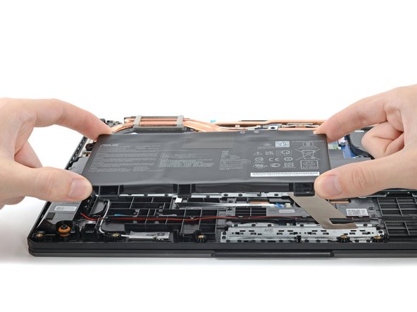

  8. ASUS TUF Gaming F15 FX506HEB-DB74 Battery Replacement, Unfasten the battery: crwdns2935265:08crwdnd2935265:01crwdnd2935265:02crwdne2935265:0 ASUS TUF Gaming F15 FX506HEB-DB74 Battery Replacement, Unfasten the battery: crwdns2935265:08crwdnd2935265:02crwdnd2935265:02crwdne2935265:0
    • Use a Phillips screwdriver to remove the two 6.1 mm-long screws securing the battery.

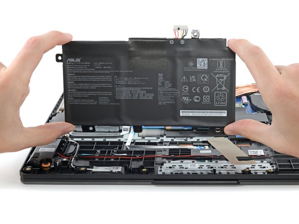

  9. ASUS TUF Gaming F15 FX506HEB-DB74 Battery Replacement, Remove the battery: crwdns2935265:09crwdnd2935265:01crwdnd2935265:03crwdne2935265:0 ASUS TUF Gaming F15 FX506HEB-DB74 Battery Replacement, Remove the battery: crwdns2935265:09crwdnd2935265:02crwdnd2935265:03crwdne2935265:0 ASUS TUF Gaming F15 FX506HEB-DB74 Battery Replacement, Remove the battery: crwdns2935265:09crwdnd2935265:03crwdnd2935265:03crwdne2935265:0
    • Lift the battery straight out of its recess and remove it.
