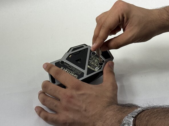

      • Make sure the mouse is unplugged and the power switch on the underside is set to the off position.

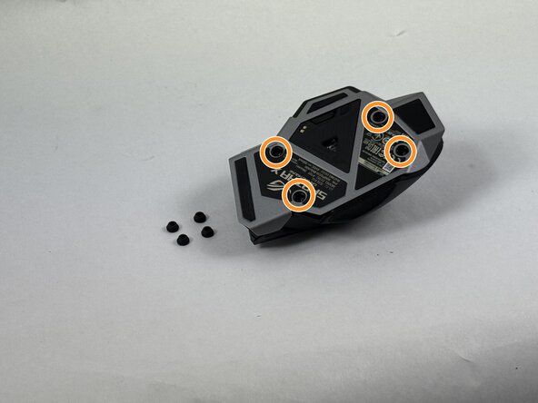

      • Use the pointed edge of a spudger to remove the four soft rubber covers on the underside of the mouse.
      • Use the included Torx screwdriver, or a T3 Torx screwdriver, to remove the four 4 mm screws.

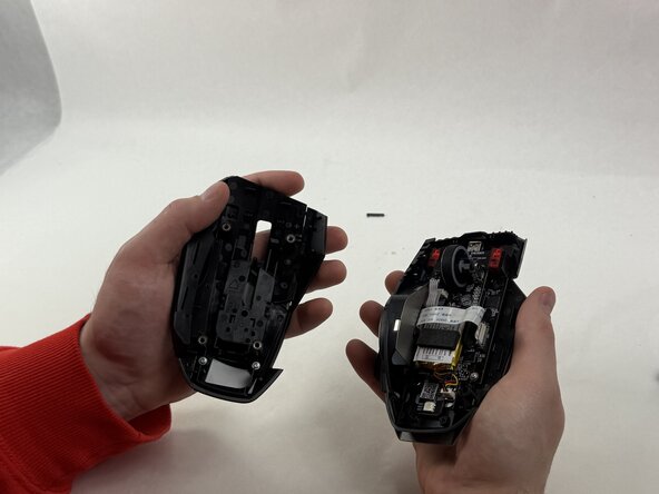

      • Lift the upper mouse cover up and off.

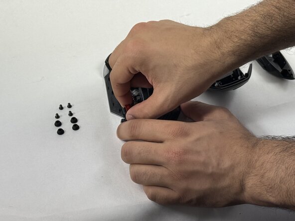

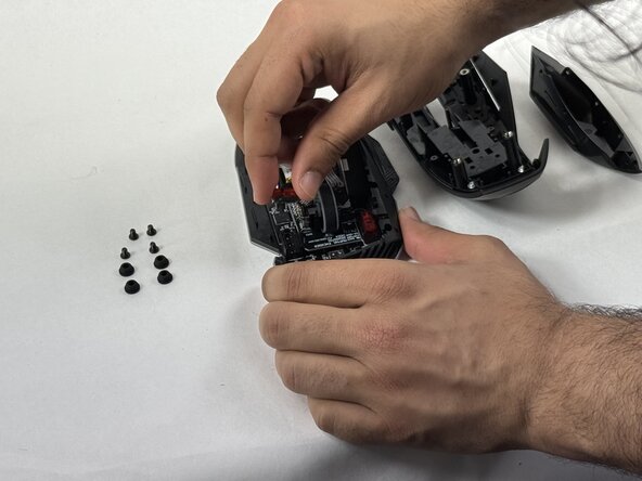

    1. ASUS ROG Spatha X Switch Replacement, Switch: crwdns2935265:03crwdnd2935265:01crwdnd2935265:03crwdne2935265:0 ASUS ROG Spatha X Switch Replacement, Switch: crwdns2935265:03crwdnd2935265:02crwdnd2935265:03crwdne2935265:0 ASUS ROG Spatha X Switch Replacement, Switch: crwdns2935265:03crwdnd2935265:03crwdnd2935265:03crwdne2935265:0
      • Remove the switch(es) you'd like to swap out by gently grabbing them on either side and pulling straight up.
