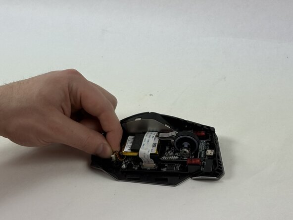

    1. ASUS ROG Spatha X Battery Replacement, Battery: crwdns2935265:03crwdnd2935265:01crwdnd2935265:03crwdne2935265:0 ASUS ROG Spatha X Battery Replacement, Battery: crwdns2935265:03crwdnd2935265:02crwdnd2935265:03crwdne2935265:0 ASUS ROG Spatha X Battery Replacement, Battery: crwdns2935265:03crwdnd2935265:03crwdnd2935265:03crwdne2935265:0
      • Grip the white battery connector and pull it up and out of its motherboard socket.

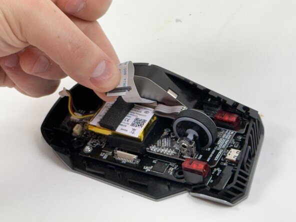

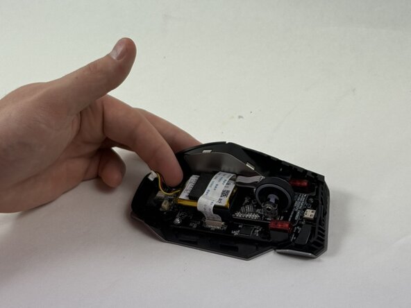

    2. ASUS ROG Spatha X Battery Replacement: crwdns2935265:04crwdnd2935265:01crwdnd2935265:02crwdne2935265:0 ASUS ROG Spatha X Battery Replacement: crwdns2935265:04crwdnd2935265:02crwdnd2935265:02crwdne2935265:0
      • Disconnect the side button assembly ribbon cable from the motherboard.
      • Use an opening tool to gently pry the battery up and out of the chassis.
      • Take care not to bend, twist, or puncture the battery.
