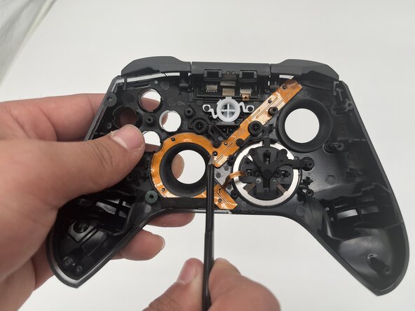

    • Make sure your controller is completely turned off before proceeding.
    • Insert the tip of an opening pick into the seam of the top left handle cover.
    • Slide it down to release the clips connecting the handle cover to the controller.
    • Remove the left handle-cover.
    • Repeat the steps to remove the right handle cover.

    • Place the tip of an opening pick or spudger in the seam of the back center panel.
    • Gently slide the pick from left to right along the seam to release the clips connecting the top and bottom of the controller.
    • Separate the top and bottom of the device.
