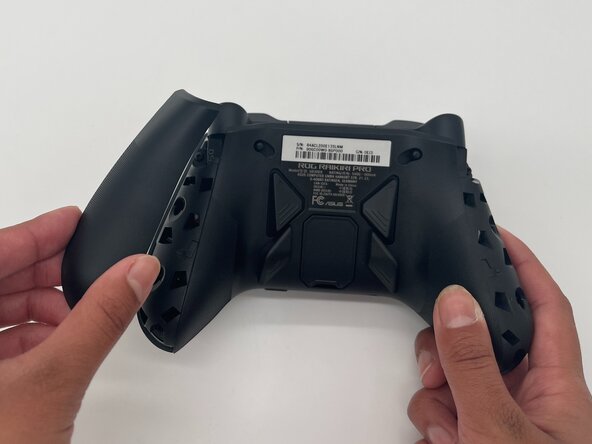

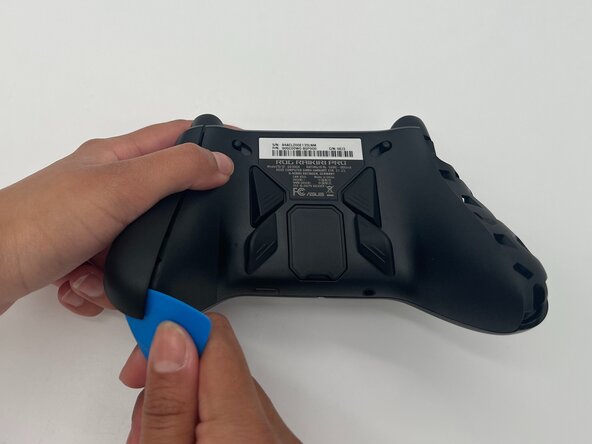

    • Make sure your controller is completely turned off before proceeding.
    • Insert the tip of an opening pick into the seam of the top left handle cover.
    • Slide it down to release the clips connecting the handle cover to the controller.
    • Repeat the steps to remove the right handle cover.
    • Remove the handle covers.

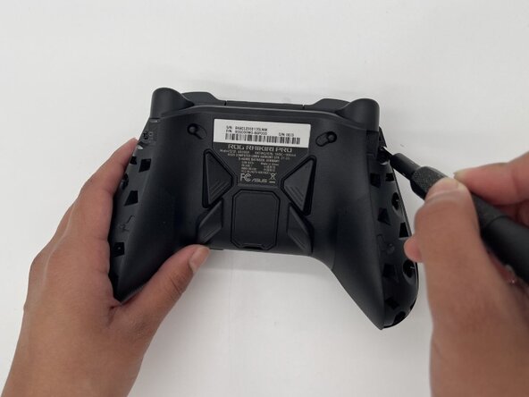

    • Use a Phillips #1 screwdriver to remove an 11 mm screw from the top of each handle.

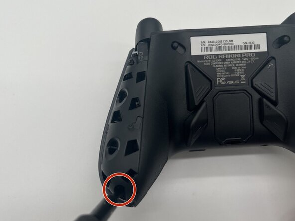

  3. ASUS ROG Raikiri Pro Joystick Cover Replacement: crwdns2935265:03crwdnd2935265:01crwdnd2935265:02crwdne2935265:0 ASUS ROG Raikiri Pro Joystick Cover Replacement: crwdns2935265:03crwdnd2935265:02crwdnd2935265:02crwdne2935265:0

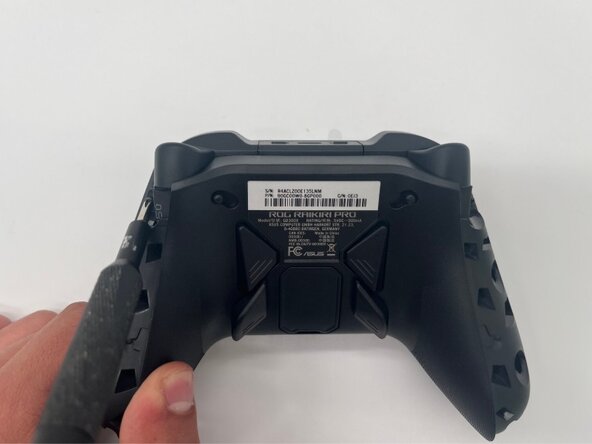

    • Use a Phillips #1 screwdriver to remove an 11 mm screw from the bottom corner of each handle.

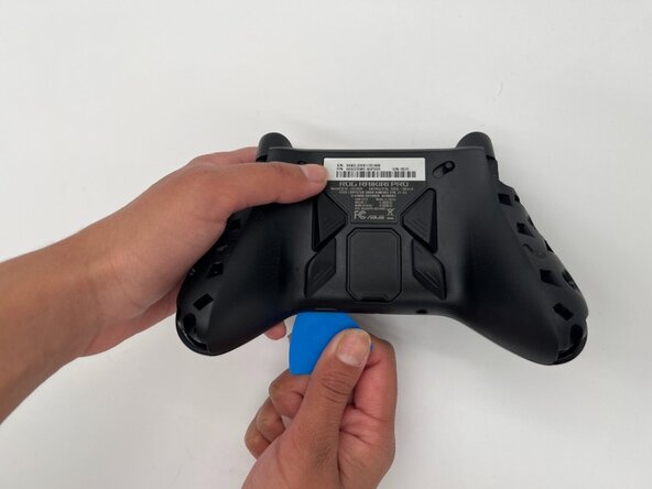

  4. ASUS ROG Raikiri Pro Joystick Cover Replacement: crwdns2935265:04crwdnd2935265:01crwdnd2935265:02crwdne2935265:0 ASUS ROG Raikiri Pro Joystick Cover Replacement: crwdns2935265:04crwdnd2935265:02crwdnd2935265:02crwdne2935265:0
    • Place the tip of an opening pick or spudger in the seam of the back center panel.
    • Gently slide the pick from left to right along the seam to release the clips connecting the top and bottom of the controller.
    • Separate the top and bottom of the device.

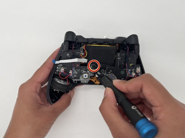

  5. ASUS ROG Raikiri Pro Joystick Cover Replacement: crwdns2935265:05crwdnd2935265:01crwdnd2935265:02crwdne2935265:0 ASUS ROG Raikiri Pro Joystick Cover Replacement: crwdns2935265:05crwdnd2935265:02crwdnd2935265:02crwdne2935265:0
    • Use a Phillips #1 screwdriver to remove the three 8 mm screws securing the left board.

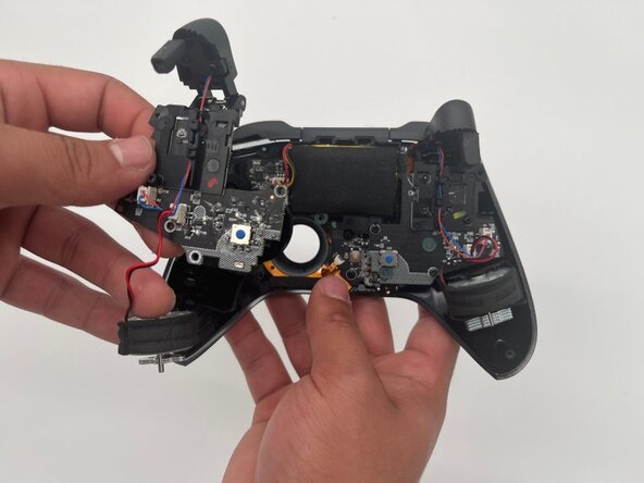

  6. ASUS ROG Raikiri Pro Joystick Cover Replacement: crwdns2935265:06crwdnd2935265:01crwdnd2935265:02crwdne2935265:0 ASUS ROG Raikiri Pro Joystick Cover Replacement: crwdns2935265:06crwdnd2935265:02crwdnd2935265:02crwdne2935265:0
    • Use a spudger to carefully remove the left board.

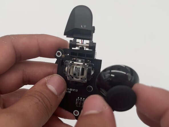

  7. ASUS ROG Raikiri Pro Joystick Cover Replacement: crwdns2935265:07crwdnd2935265:01crwdnd2935265:02crwdne2935265:0 ASUS ROG Raikiri Pro Joystick Cover Replacement: crwdns2935265:07crwdnd2935265:02crwdnd2935265:02crwdne2935265:0
    • Flip the board over and remove the joystick cover.
