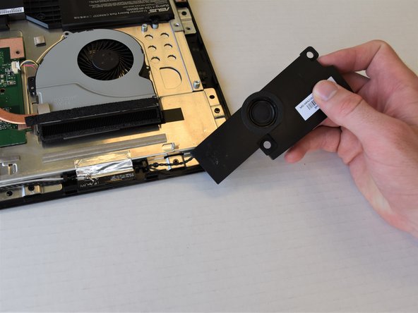

  4. ASUS Portable AiO PT2001 Speaker Replacement, Speaker: crwdns2935265:04crwdnd2935265:01crwdnd2935265:02crwdne2935265:0 ASUS Portable AiO PT2001 Speaker Replacement, Speaker: crwdns2935265:04crwdnd2935265:02crwdnd2935265:02crwdne2935265:0
    • The two in-house speakers are located near the sides of the device with the motherboard in between.
    • Remove the two 2.35 mm Phillips #1 screws from each speaker.

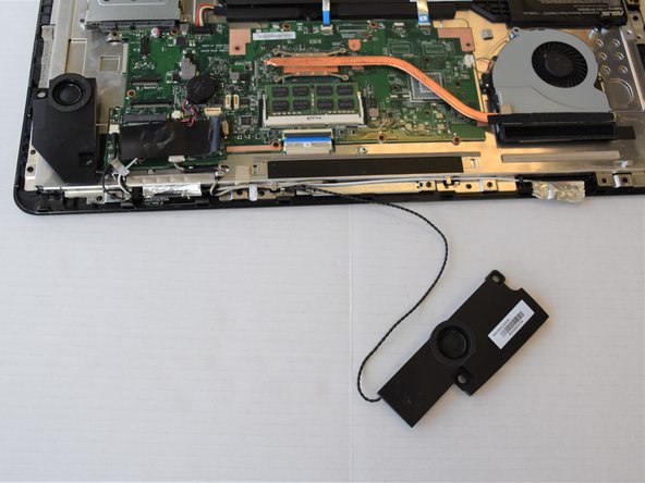

  5. ASUS Portable AiO PT2001 Speaker Replacement: crwdns2935265:05crwdnd2935265:01crwdnd2935265:02crwdne2935265:0 ASUS Portable AiO PT2001 Speaker Replacement: crwdns2935265:05crwdnd2935265:02crwdnd2935265:02crwdne2935265:0
    • The two speakers are attached to each other with a cord that is threaded along the side of the casing. Gently pull the wire out
    • The cord is secured under two pieces of tape with multiple other wires. Make sure that you only remove the wire connecting the speakers.
    • Keep in mind that when replacing the wires, you will need to secure the tape again. Accordingly, be careful not to tear the tape when peeling it.
  6. ASUS Portable AiO PT2001 Speaker Replacement: crwdns2935265:06crwdnd2935265:01crwdnd2935265:01crwdne2935265:0
    • Pull the cord attached to the speaker out of the motherboard
