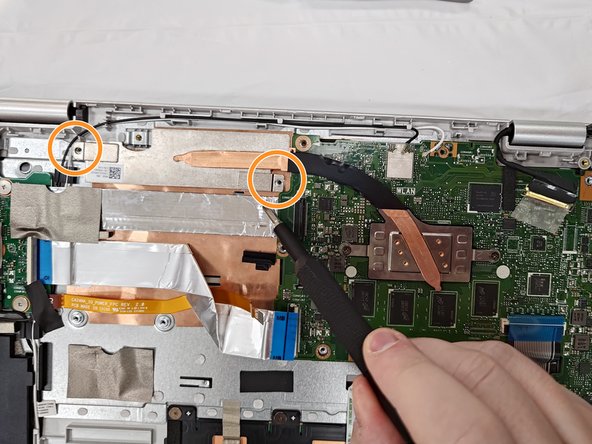

    • Remove the two 2.8 mm Phillips screws that secure the motherboard.
    • Remove the two 3.3 mm Phillips screws.

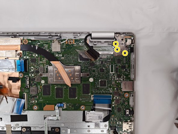

    • Remove the three 1.4 mm Phillips screws that secure the hinge located at the top-right section of the motherboard.
  12. ASUS Chromebook C424MA-DH48F Motherboard Replacement: crwdns2935265:012crwdnd2935265:01crwdnd2935265:01crwdne2935265:0
    • Lift up on the top-right hinge until it's out of the way of the motherboard.
