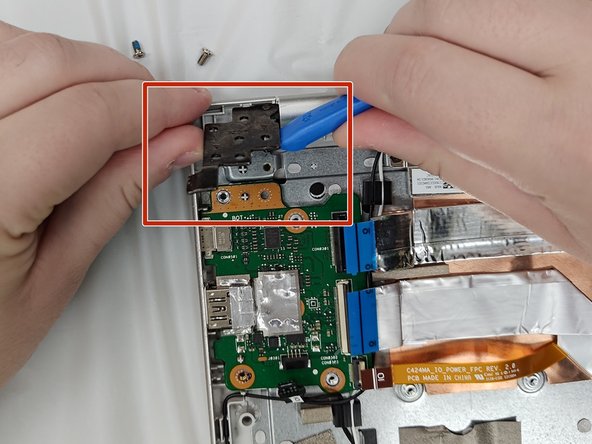

  6. ASUS Chromebook C424MA-DH48F Daughterboard Replacement: crwdns2935265:06crwdnd2935265:01crwdnd2935265:01crwdne2935265:0
    • Remove the three 3.3 mm screws from the top left hinge bracket.
  7. ASUS Chromebook C424MA-DH48F Daughterboard Replacement: crwdns2935265:07crwdnd2935265:01crwdnd2935265:02crwdne2935265:0 ASUS Chromebook C424MA-DH48F Daughterboard Replacement: crwdns2935265:07crwdnd2935265:02crwdnd2935265:02crwdne2935265:0
    • Use an opening tool lift the left hinge bracket out of the way of the daughterboard.
  8. ASUS Chromebook C424MA-DH48F Daughterboard Replacement: crwdns2935265:08crwdnd2935265:01crwdnd2935265:01crwdne2935265:0
    • Remove the daughterboard by pulling straight up then back towards the motherboard.
