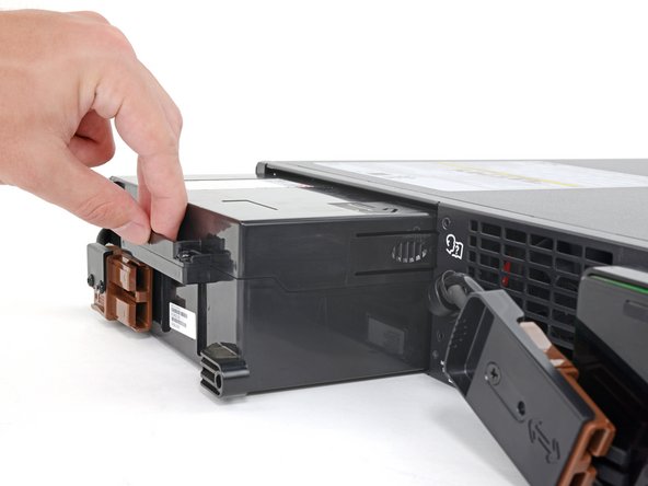

  7. APC Smart-UPS SRT30000XLA Battery Assembly Replacement, Remove the battery assembly: crwdns2935265:07crwdnd2935265:01crwdnd2935265:02crwdne2935265:0 APC Smart-UPS SRT30000XLA Battery Assembly Replacement, Remove the battery assembly: crwdns2935265:07crwdnd2935265:02crwdnd2935265:02crwdne2935265:0
    • Pull the battery assembly out of the housing until it stops at its first plastic tab.
    • You'll feel the assembly stop abruptly and hear the plastic tab "click."
  8. APC Smart-UPS SRT30000XLA Battery Assembly Replacement: crwdns2935265:08crwdnd2935265:01crwdnd2935265:03crwdne2935265:0 APC Smart-UPS SRT30000XLA Battery Assembly Replacement: crwdns2935265:08crwdnd2935265:02crwdnd2935265:03crwdne2935265:0 APC Smart-UPS SRT30000XLA Battery Assembly Replacement: crwdns2935265:08crwdnd2935265:03crwdnd2935265:03crwdne2935265:0
    • Depress the plastic tab while pulling on the battery assembly until it clears the tab.
  9. APC Smart-UPS SRT30000XLA Battery Assembly Replacement: crwdns2935265:09crwdnd2935265:01crwdnd2935265:02crwdne2935265:0 APC Smart-UPS SRT30000XLA Battery Assembly Replacement: crwdns2935265:09crwdnd2935265:02crwdnd2935265:02crwdne2935265:0
    • Continue pulling the battery assembly out of the housing until it stops at its second plastic tab.
  10. APC Smart-UPS SRT30000XLA Battery Assembly Replacement: crwdns2935265:010crwdnd2935265:01crwdnd2935265:03crwdne2935265:0 APC Smart-UPS SRT30000XLA Battery Assembly Replacement: crwdns2935265:010crwdnd2935265:02crwdnd2935265:03crwdne2935265:0 APC Smart-UPS SRT30000XLA Battery Assembly Replacement: crwdns2935265:010crwdnd2935265:03crwdnd2935265:03crwdne2935265:0
    • Depress the plastic tab while pulling on the battery assembly until it’s free from the housing.
  11. APC Smart-UPS SRT30000XLA Battery Assembly Replacement, Only the battery assembly remains: crwdns2935265:011crwdnd2935265:01crwdnd2935265:01crwdne2935265:0
    • You're now left with the battery assembly.
