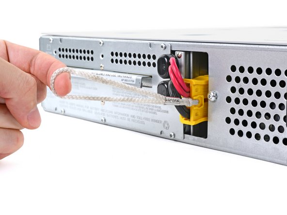

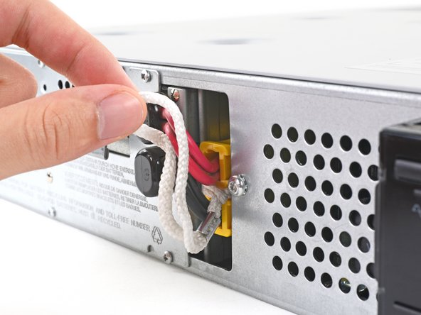

  4. APC Smart-UPS SMT1500RM2UC Battery Cartridge Replacement, Remove the battery disconnect string: crwdns2935265:04crwdnd2935265:01crwdnd2935265:02crwdne2935265:0 APC Smart-UPS SMT1500RM2UC Battery Cartridge Replacement, Remove the battery disconnect string: crwdns2935265:04crwdnd2935265:02crwdnd2935265:02crwdne2935265:0
    • Pull the battery disconnect string out of its recess in the middle of the front edge.

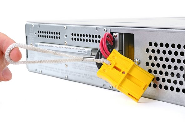

  5. APC Smart-UPS SMT1500RM2UC Battery Cartridge Replacement, Disconnect the battery: crwdns2935265:05crwdnd2935265:01crwdnd2935265:03crwdne2935265:0 APC Smart-UPS SMT1500RM2UC Battery Cartridge Replacement, Disconnect the battery: crwdns2935265:05crwdnd2935265:02crwdnd2935265:03crwdne2935265:0 APC Smart-UPS SMT1500RM2UC Battery Cartridge Replacement, Disconnect the battery: crwdns2935265:05crwdnd2935265:03crwdnd2935265:03crwdne2935265:0
    • Use the battery disconnect string to pull the yellow connector completely out of its socket, disconnecting the battery.

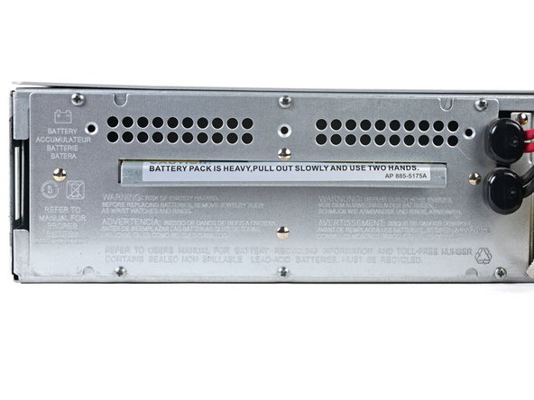

  6. APC Smart-UPS SMT1500RM2UC Battery Cartridge Replacement, Unfasten the battery cartridge: crwdns2935265:06crwdnd2935265:01crwdnd2935265:02crwdne2935265:0 APC Smart-UPS SMT1500RM2UC Battery Cartridge Replacement, Unfasten the battery cartridge: crwdns2935265:06crwdnd2935265:02crwdnd2935265:02crwdne2935265:0
    • Use a Phillips screwdriver to remove the six 11.2 mm‑long screws securing the battery cartridge.

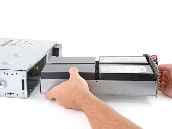

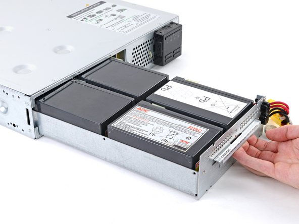

  7. APC Smart-UPS SMT1500RM2UC Battery Cartridge Replacement, Remove the battery cartridge: crwdns2935265:07crwdnd2935265:01crwdnd2935265:02crwdne2935265:0 APC Smart-UPS SMT1500RM2UC Battery Cartridge Replacement, Remove the battery cartridge: crwdns2935265:07crwdnd2935265:02crwdnd2935265:02crwdne2935265:0
    • Slide the battery cartridge out of the device until it stops.
