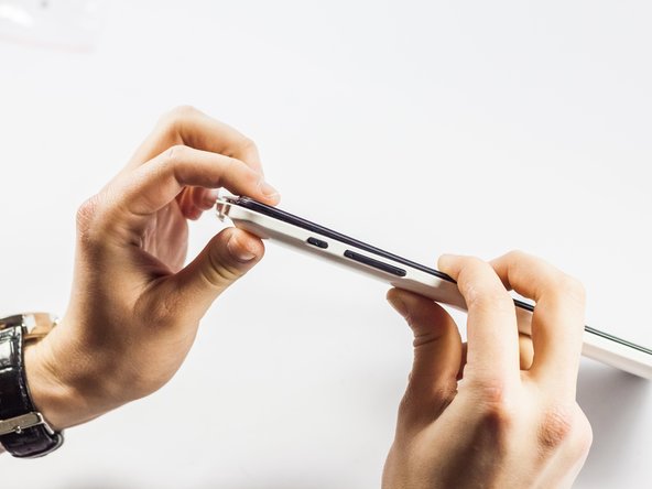

    • Remove screws.
    • Insert spudger tool on the middle of the left side, between the white and black plastic.
    • Slide in a plastic opening tool and use it to further pull the back off.
    • Work your way around the edge of the tablet with the plastic opening tool and insert more as needed.
    • Pull off the back cover.

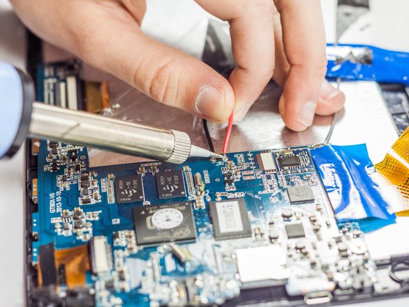

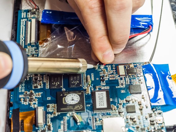

    • Locate the battery unit solder points and note where it is attached to the motherboard.
    • Plug in your soldering iron/pen and wait the required amount of time to heat up.
    • Be careful with the iron as the tip is very hot and it could burn you or the tablet
    • Apply a small amount of pressure with the iron on the solder points until the joints come loose and the wires move freely away from the board
    • Remove the battery unit

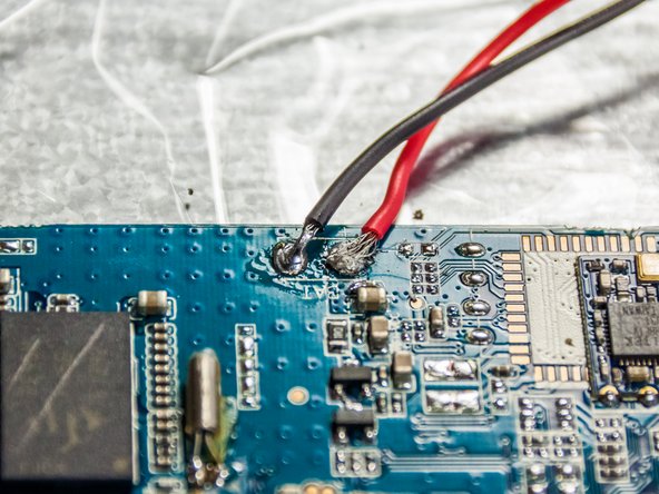

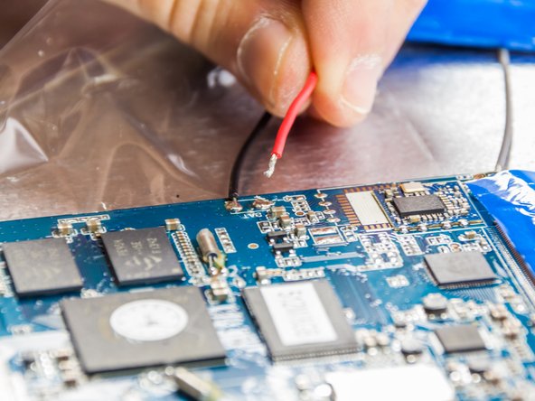

    • Locate the red and black wire ends of your new battery
    • Take your solder out and place it on the point with the wire
    • Use the iron/pen to slowly melt a small piece of solder onto the point and let it solidify.
    • Be careful not to use too much solder as a large blob could result in a short on your device
    • Repeat this step for the other point

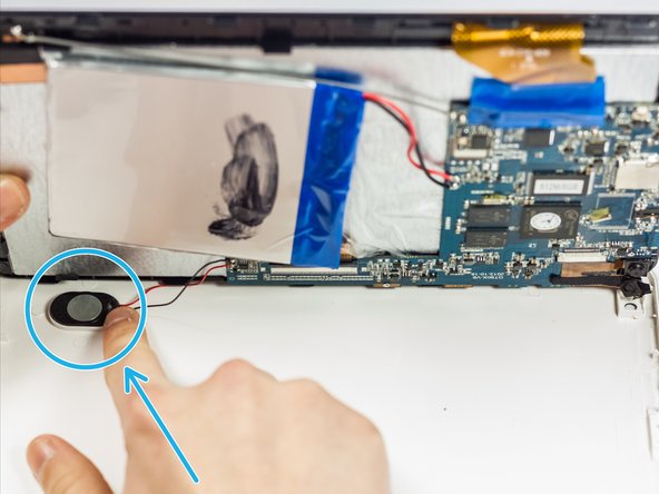

    • Replace the back cover with the new part in place.
    • Gently press the speaker into place.
    • Don't let the volume rocker unit fall out of place.
    • Replace the screws.
