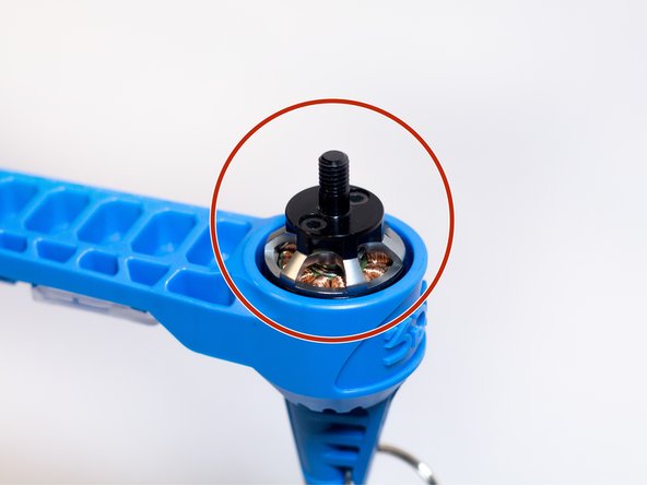

  2. 3DR Iris Plus Quadcopter Motor Replacement, Propeller: crwdns2935265:02crwdnd2935265:01crwdnd2935265:02crwdne2935265:0 3DR Iris Plus Quadcopter Motor Replacement, Propeller: crwdns2935265:02crwdnd2935265:02crwdnd2935265:02crwdne2935265:0
    • Take note of the propeller cap color (either black or silver).
    • Hold down the motor assembly and twist the propeller clockwise to unlock it (you should feel some resistance until it starts to unscrew freely).
    • Hold down the motor assembly and twist the propeller counterclockwise to unlock it (you should feel some resistance until it starts to unscrew freely).
    • This is the motor assembly.

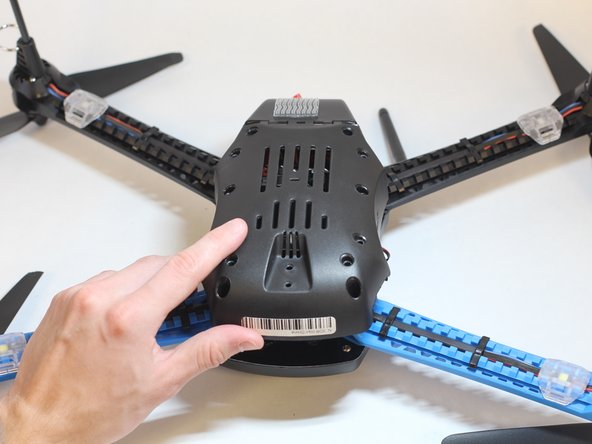

  10. 3DR Iris Plus Quadcopter Motor Replacement: crwdns2935265:010crwdnd2935265:01crwdnd2935265:03crwdne2935265:0 3DR Iris Plus Quadcopter Motor Replacement: crwdns2935265:010crwdnd2935265:02crwdnd2935265:03crwdne2935265:0 3DR Iris Plus Quadcopter Motor Replacement: crwdns2935265:010crwdnd2935265:03crwdnd2935265:03crwdne2935265:0
    • Feed both wires through the grill of the bottom shell.
    • Lift to remove the shell.
    • There are two cables tethering the shell to the body of the drone. It is difficult and unnecessary to remove them. Simply lay the shell to the side.

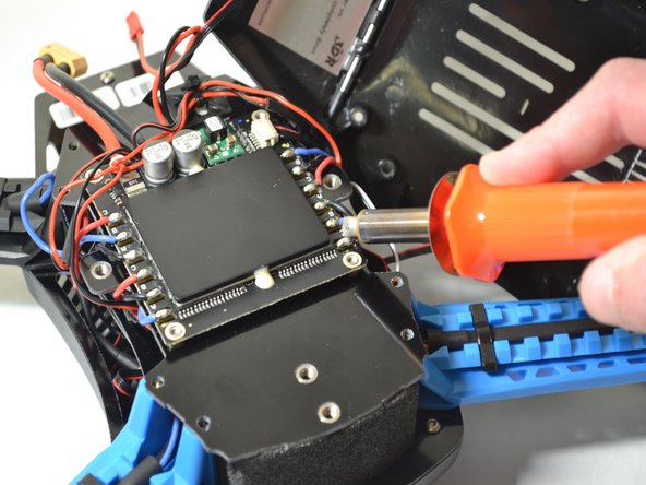

  11. 3DR Iris Plus Quadcopter Motor Replacement, Motor: crwdns2935265:011crwdnd2935265:01crwdnd2935265:02crwdne2935265:0 3DR Iris Plus Quadcopter Motor Replacement, Motor: crwdns2935265:011crwdnd2935265:02crwdnd2935265:02crwdne2935265:0
    • Ensure that the drone is in the same orientation as the picture (power connector and capacitors on the bottom).
    • Top-left motor power cables
    • Top-right motor power cables
    • Bottom-left motor power cables
    • Bottom-right motor power cables
    • Desolder the motor power cables closest to the motor that you are replacing (the cables in each corner route to the closest leg).
    • Exercise caution and follow proper desoldering procedures to ensure safety.

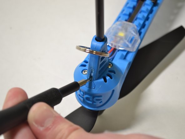

    • On the leg that the motor is attached to, remove the 8mm screw that holds the long leg foot in place using the 1.5 mm Hex screwdriver/key.
  13. 3DR Iris Plus Quadcopter Motor Replacement: crwdns2935265:013crwdnd2935265:01crwdnd2935265:03crwdne2935265:0 3DR Iris Plus Quadcopter Motor Replacement: crwdns2935265:013crwdnd2935265:02crwdnd2935265:03crwdne2935265:0 3DR Iris Plus Quadcopter Motor Replacement: crwdns2935265:013crwdnd2935265:03crwdnd2935265:03crwdne2935265:0

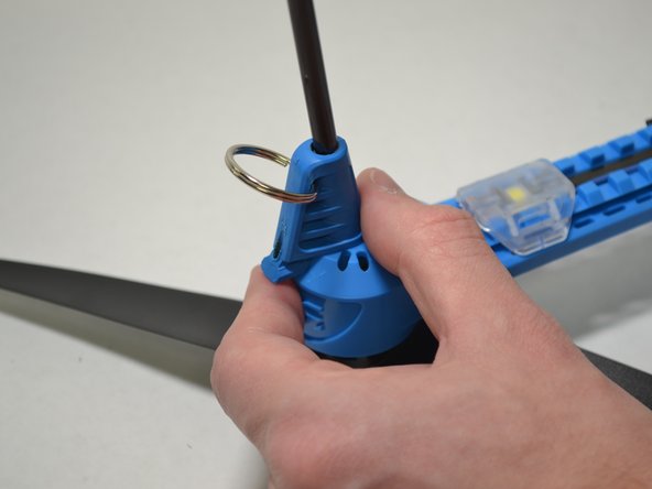

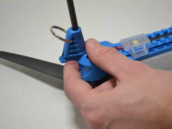

    • Slide the leg foot out of the leg assembly.
  14. 3DR Iris Plus Quadcopter Motor Replacement: crwdns2935265:014crwdnd2935265:01crwdnd2935265:03crwdne2935265:0 3DR Iris Plus Quadcopter Motor Replacement: crwdns2935265:014crwdnd2935265:02crwdnd2935265:03crwdne2935265:0 3DR Iris Plus Quadcopter Motor Replacement: crwdns2935265:014crwdnd2935265:03crwdnd2935265:03crwdne2935265:0

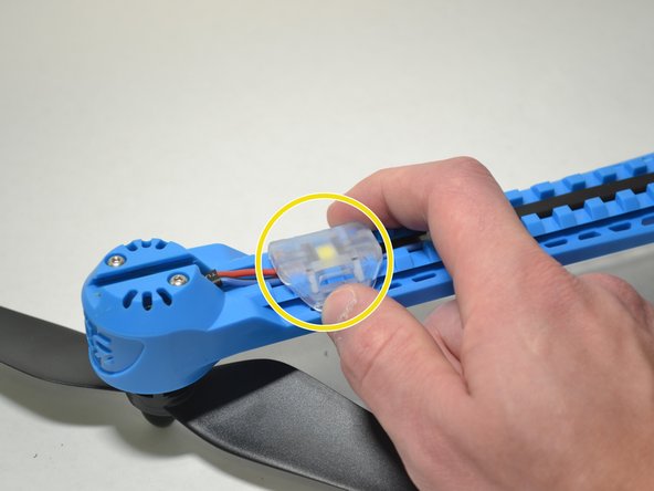

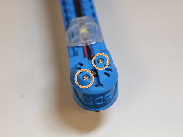

    • Remove each of the plastic clips holding the motor cables in by snapping them out.
    • Remove the two 9mm screws using a 2 mm Hex screwdriver/key. Once removed, the motor will hang freely from the leg chassis.
    • Remove the LED assembly by snapping it off the clips that are attached to the drone leg.
  15. 3DR Iris Plus Quadcopter Motor Replacement: crwdns2935265:015crwdnd2935265:01crwdnd2935265:01crwdne2935265:0
    • To remove the motor assembly, pull the motor assembly through and out of the leg chassis.

Thanks for the info Duncan , I am finding it difficult to simply snap off the led clip away from the arm is there a secret? Lol!
