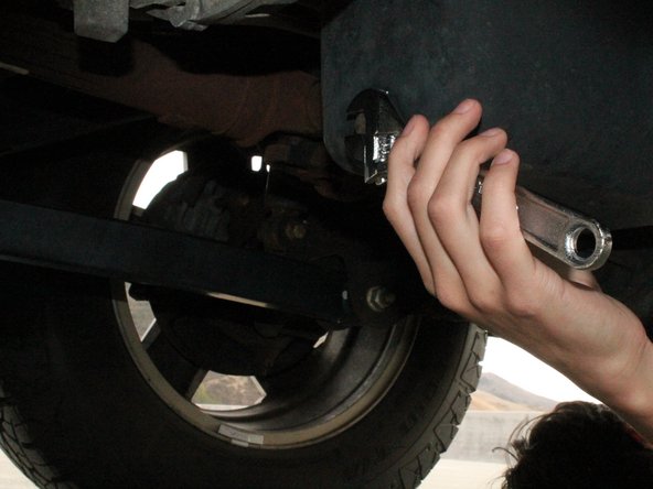

  5. 2007-2012 Jeep Wrangler Oil Change: crwdns2935265:05crwdnd2935265:01crwdnd2935265:02crwdne2935265:0 2007-2012 Jeep Wrangler Oil Change: crwdns2935265:05crwdnd2935265:02crwdnd2935265:02crwdne2935265:0
    • Using an appropriately sized socket and socket wrench, remove the oil drain plug. (In a pinch, you can use an adjustable wrench.) Twist counter-clockwise to loosen it.
    • Let the oil completely drain from the car and into the drain pan.
    • Replace (reinsert) the plug by twisting it clockwise. Tighten it with the wrench following the same clockwise motion.
    • After the plug is replaced, wipe it down with a dirty rag to clean off any outside oil. This ensures that oil will not drip onto the ground.

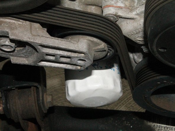

  6. 2007-2012 Jeep Wrangler Oil Change: crwdns2935265:06crwdnd2935265:01crwdnd2935265:01crwdne2935265:0
    • Move the drain pan toward the front of the vehicle. Be careful not to spill any oil!
    • Place it directly underneath the oil filter (indicated by the red square in the image). This image is looking down from the front of the engine, underneath the hood.

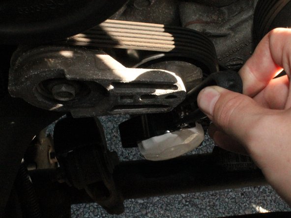

  7. 2007-2012 Jeep Wrangler Oil Change: crwdns2935265:07crwdnd2935265:01crwdnd2935265:03crwdne2935265:0 2007-2012 Jeep Wrangler Oil Change: crwdns2935265:07crwdnd2935265:02crwdnd2935265:03crwdne2935265:0 2007-2012 Jeep Wrangler Oil Change: crwdns2935265:07crwdnd2935265:03crwdnd2935265:03crwdne2935265:0
    • Oil will begin flowing as soon as you unscrew the filter. Be sure to catch all of the oil in the drain pan.

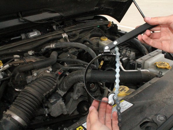

    • Loosen the oil filter by twisting counter-clockwise. It may be easier to access the oil filter from the top-side of the engine.
    • If it is too difficult to twist by hand, use an oil filter wrench to loosen it.
    • Place the removed oil filter in the oil pan.

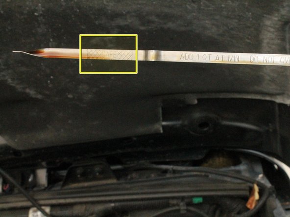

    • Check the oil level. First, locate the oil dip-stick (marked in the first image by red).
    • Pull out the oil dip-stick and wipe clean it clean with a paper towel or rag.
    • Re-insert the oil dip-stick completely and pull it slowly out.
    • The oil should reach to the safe-fill area on the stick (marked in the image in yellow). If it doesn't, add more fresh oil through the funnel until it reaches this mark.

The use of an adjustable wrench to remove the drain-plug is ill-advised. A rounded off plug will be extremely difficult to shift. Get a socket, or a drain plug wrench.
Someone forgot to install the filter gasket ring. They frequently can be found loose in the box, and can be forgotten if you dont know there should be one. But you wont do it a second time!
