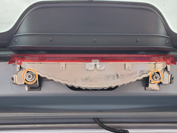

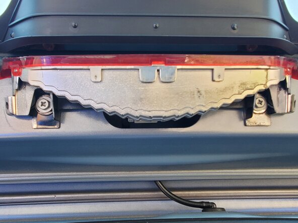

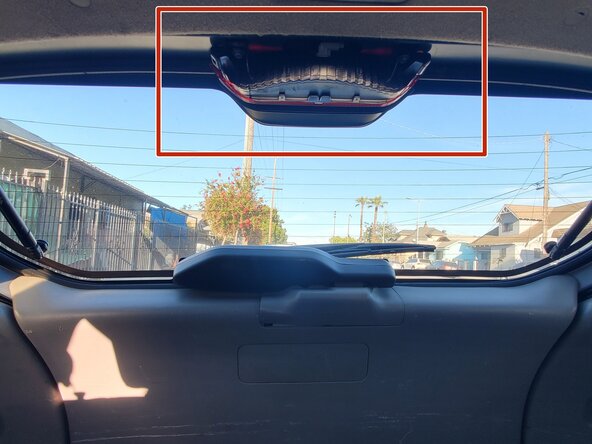

    • Open the trunk.
    • The brake light is located at the upper center of the inside of the trunk window.
  2. 2006 Toyota Matrix Center Brake Light Bulb Replacement: crwdns2935265:02crwdnd2935265:01crwdnd2935265:03crwdne2935265:0 2006 Toyota Matrix Center Brake Light Bulb Replacement: crwdns2935265:02crwdnd2935265:02crwdnd2935265:03crwdne2935265:0 2006 Toyota Matrix Center Brake Light Bulb Replacement: crwdns2935265:02crwdnd2935265:03crwdnd2935265:03crwdne2935265:0

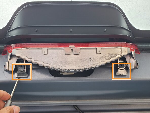

    • Use a Phillips screwdriver to remove two screws from the brake light mount.

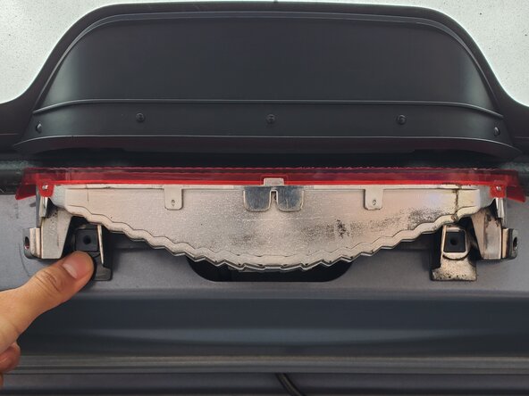

    • Use a flathead screwdriver to pry the brake light mount on both sides and push out the black plastic fasteners.
    • To prevent the brake light mount from falling, hold it in place while pushing out the plastic fasteners.

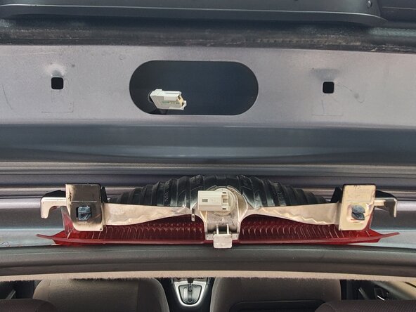

  3. 2006 Toyota Matrix Center Brake Light Bulb Replacement: crwdns2935265:03crwdnd2935265:01crwdnd2935265:03crwdne2935265:0 2006 Toyota Matrix Center Brake Light Bulb Replacement: crwdns2935265:03crwdnd2935265:02crwdnd2935265:03crwdne2935265:0 2006 Toyota Matrix Center Brake Light Bulb Replacement: crwdns2935265:03crwdnd2935265:03crwdnd2935265:03crwdne2935265:0

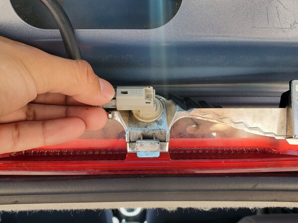

    • Hold the brake mount in place, carefully press down on the brake light cable connector, and remove it from the socket.

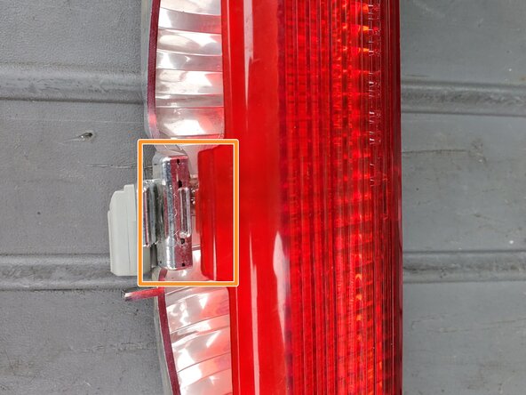

  4. 2006 Toyota Matrix Center Brake Light Bulb Replacement: crwdns2935265:04crwdnd2935265:01crwdnd2935265:03crwdne2935265:0 2006 Toyota Matrix Center Brake Light Bulb Replacement: crwdns2935265:04crwdnd2935265:02crwdnd2935265:03crwdne2935265:0 2006 Toyota Matrix Center Brake Light Bulb Replacement: crwdns2935265:04crwdnd2935265:03crwdnd2935265:03crwdne2935265:0

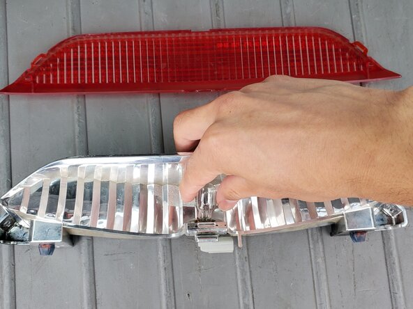

    • Unclip the red light cover from the mounting points on both the front-left and front-right sides.
    • Gently wiggle and pull out the light bulb from its location.

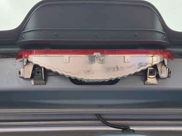

  5. 2006 Toyota Matrix Center Brake Light Bulb Replacement: crwdns2935265:05crwdnd2935265:01crwdnd2935265:03crwdne2935265:0 2006 Toyota Matrix Center Brake Light Bulb Replacement: crwdns2935265:05crwdnd2935265:02crwdnd2935265:03crwdne2935265:0 2006 Toyota Matrix Center Brake Light Bulb Replacement: crwdns2935265:05crwdnd2935265:03crwdnd2935265:03crwdne2935265:0

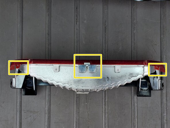

    • Insert the new light bulb, then carefully press down to secure the light bulb.
    • Insert the center clip of the red cover into the slot on the brake light mount.
    • Clip the lens front-side left and right clipping position into the mount's designated clipping locations.

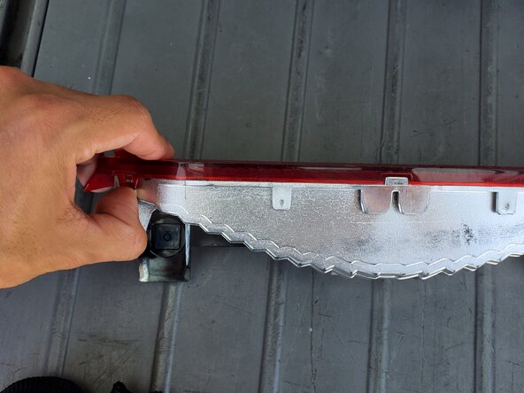

  6. 2006 Toyota Matrix Center Brake Light Bulb Replacement: crwdns2935265:06crwdnd2935265:01crwdnd2935265:03crwdne2935265:0 2006 Toyota Matrix Center Brake Light Bulb Replacement: crwdns2935265:06crwdnd2935265:02crwdnd2935265:03crwdne2935265:0 2006 Toyota Matrix Center Brake Light Bulb Replacement: crwdns2935265:06crwdnd2935265:03crwdnd2935265:03crwdne2935265:0
    • Reconnect the brake light mount to the cable attachment.
    • Push the mount's black plastic fasteners into the highlighted holes.
    • Use moderate force to push in the plastic fasteners
    • Replace the two Phillips screws into the brake light mount.
