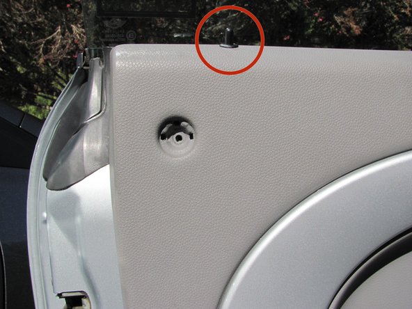

    • With the screws removed, you will need to pry the panel off of the door using a prybar or flathead screwdriver. I wrapped my screwdriver in electrical tape to keep it from scratching the car.
    • The bottom and sides of the panel are held on with one type of clip while the top is held on by another. Because of this, you want to start prying it somewhere along the bottom edge of the panel, I chose the lower outside corner.
  3. 2001-2006 Mini Cooper Lock Actuator Replacement: crwdns2935265:03crwdnd2935265:01crwdnd2935265:02crwdne2935265:0 2001-2006 Mini Cooper Lock Actuator Replacement: crwdns2935265:03crwdnd2935265:02crwdnd2935265:02crwdne2935265:0
    • Once you have the bottom and sides of the panel popped off the tabs, you want to to a combination of lifting and pulling along the top edge to remove it from these other types of tabs.
    • Once the panel is free from these, you can slide it over the door lock knob and pull the whole thing away.

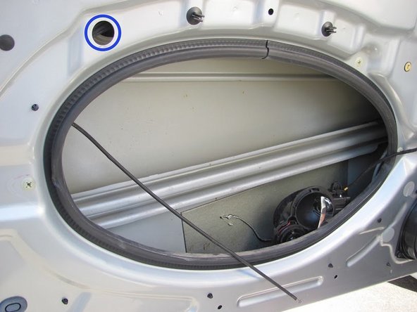

    • Unscrew the three Phillips screws from the handle and speaker component.
    • Remove the handle from the door panel so that you can remove the cable.
    • You can pull out the cable from the back of the handle by pulling back on the housing cable, and rotating the cable counter-clockwise in the socket so that it lines up with the opening as to be pulled out.
  5. 2001-2006 Mini Cooper Lock Actuator Replacement: crwdns2935265:05crwdnd2935265:01crwdnd2935265:03crwdne2935265:0 2001-2006 Mini Cooper Lock Actuator Replacement: crwdns2935265:05crwdnd2935265:02crwdnd2935265:03crwdne2935265:0 2001-2006 Mini Cooper Lock Actuator Replacement: crwdns2935265:05crwdnd2935265:03crwdnd2935265:03crwdne2935265:0
    • Fold the rubber grommet, which is located on the left top side of the door panel, then push it into the inside of the hole in order to put the cable to the inside of the door panel.
    • Peel out the rubber, which holds the door lock, from the door panel.
  6. 2001-2006 Mini Cooper Lock Actuator Replacement: crwdns2935265:06crwdnd2935265:01crwdnd2935265:02crwdne2935265:0 2001-2006 Mini Cooper Lock Actuator Replacement: crwdns2935265:06crwdnd2935265:02crwdnd2935265:02crwdne2935265:0
    • Take off the cable from the door panel clips in order to put the cable into the door panel.
    • Push the cable through the door panel hole, which was blocked by the rubber before.

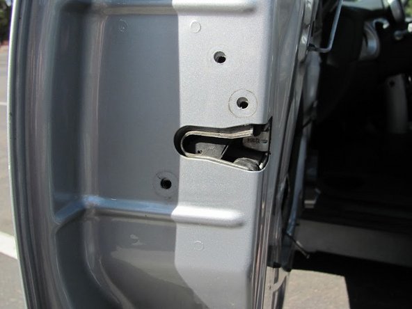

    • The actuator mechanism is attached to the car door with three bolts, which are on the end of the door (the left side when looking at the opening). These bolts can be removed with a T25 Torx screwdriver.
  9. 2001-2006 Mini Cooper Lock Actuator Replacement: crwdns2935265:09crwdnd2935265:01crwdnd2935265:02crwdne2935265:0 2001-2006 Mini Cooper Lock Actuator Replacement: crwdns2935265:09crwdnd2935265:02crwdnd2935265:02crwdne2935265:0

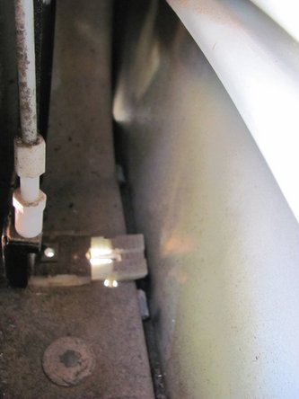

    • Looking inside the door, this is what you will see. You will need to detach the cable shown which connects the outside door handle to the housing. This is done by pushing the lever arm with the white plastic clip on it down.
    • That releases the tension in the cable so you can release it from the hook on the bottom by turning it sideways.

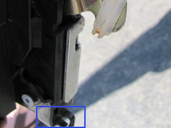

    • Lastly, if you need to detach the inside handle cable from the actuator, you just need to pop the door open on the side of the housing.
    • The blue cable end can be pulled straight up from the place holders it sits in.
    • The actual cable is just hooked on the end and can be taken off pretty easily.
    • In order to put the locking mechanism back, just follow these directions in reverse order.
    • When putting the actuator back in, slotting the blue cap in the right grooves can be a little tricky when it's inside the door so I advise doing it once or twice while it's outside to get the feel for it.
