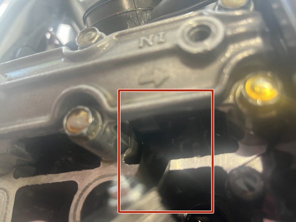

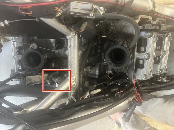

  12. 1999-2002 Suzuki SV650 Valve Inspection and Adjustment Replacement, Loosen the clamps from the carbs on the Head Cylinder: crwdns2935265:012crwdnd2935265:01crwdnd2935265:01crwdne2935265:0
    • Before pulling the carbs off loosen the clamps on both the front and rear. Use your JIP-4 Screwdriver
  13. 1999-2002 Suzuki SV650 Valve Inspection and Adjustment Replacement, Loosen the carb from the Motorcycle: crwdns2935265:013crwdnd2935265:01crwdnd2935265:01crwdne2935265:0
    • From this point on we will disconnect the carb from the head. This will make it so we can perform the next step easier
    • Slowly pull from the top "gold" handle towards you. Do this from the opposite side of where you are pulling. You will need to use some strength but not a lot. This should easily disconnect the carb from the head
    • Do not pull the carburetor off and away from the bike as of yet. There are still the throttle cables and choke cables that need to be removed. Otherwise, you could break these.
  14. 1999-2002 Suzuki SV650 Valve Inspection and Adjustment Replacement, Removing the Choke Cables.: crwdns2935265:014crwdnd2935265:01crwdnd2935265:02crwdne2935265:0 1999-2002 Suzuki SV650 Valve Inspection and Adjustment Replacement, Removing the Choke Cables.: crwdns2935265:014crwdnd2935265:02crwdnd2935265:02crwdne2935265:0
    • Start by grabbing your JIP-4 screwdriver and slowly removing the screws. If they have never been touched before they can be hard to remove. Try your best not to strip these. After you are done with the first slowly pull the cable out of the carburator "body". Repeat the same caution for the second choke cable
    • The first picture is of the rear carb, the second picture is of the front
  15. 1999-2002 Suzuki SV650 Valve Inspection and Adjustment Replacement, Loosen the Throttle cables: crwdns2935265:015crwdnd2935265:01crwdnd2935265:02crwdne2935265:0 1999-2002 Suzuki SV650 Valve Inspection and Adjustment Replacement, Loosen the Throttle cables: crwdns2935265:015crwdnd2935265:02crwdnd2935265:02crwdne2935265:0
    • These will be found on the front right side of the carbs. It is also unnecessary to completely remove the nut. Just loosen them enough until they are able to be removed
    • Loosen the throttle cable nuts until they can be removed completely
    • Afterwards pull the cables out, you may need to use the screwdriver to push them out completely
  16. 1999-2002 Suzuki SV650 Valve Inspection and Adjustment Replacement, Disconnect the TPS Sensor: crwdns2935265:016crwdnd2935265:01crwdnd2935265:01crwdne2935265:0
    • Be careful not to forget to remove this. This will be located at the right of the rear carb
    • Carefully push in the clip and disconnect the cable.
  17. 1999-2002 Suzuki SV650 Valve Inspection and Adjustment Replacement, Remove the carb completely: crwdns2935265:017crwdnd2935265:01crwdnd2935265:01crwdne2935265:0
    • Congratulations. You can now take out the carb completely of the motorcycle!
    • The carb has an idle adjustment screw that is in a bracket. Mine was not in such a bracket so I could not show you but be careful when pulling the carb out that you do not damage said bracket

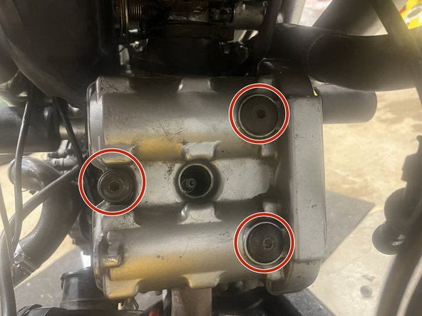

  18. 1999-2002 Suzuki SV650 Valve Inspection and Adjustment Replacement, Removing the rear and front Cylinder Head Cover: crwdns2935265:018crwdnd2935265:01crwdnd2935265:02crwdne2935265:0 1999-2002 Suzuki SV650 Valve Inspection and Adjustment Replacement, Removing the rear and front Cylinder Head Cover: crwdns2935265:018crwdnd2935265:02crwdnd2935265:02crwdne2935265:0
    • Use a 6 mm Allen Socket to remove all three of these. They hold the cover down on the front and rear heads.
    • Do NOT use SAE tools. Only Metric. You WILL strip these if you are not careful and use the wrong one.

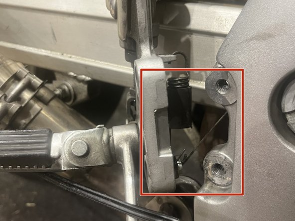

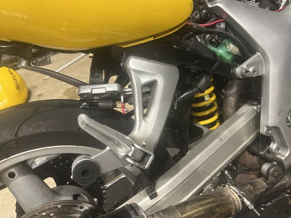

  19. 1999-2002 Suzuki SV650 Valve Inspection and Adjustment Replacement, Unscrew and Tuck Away Rear brake Paddle: crwdns2935265:019crwdnd2935265:01crwdnd2935265:03crwdne2935265:0 1999-2002 Suzuki SV650 Valve Inspection and Adjustment Replacement, Unscrew and Tuck Away Rear brake Paddle: crwdns2935265:019crwdnd2935265:02crwdnd2935265:03crwdne2935265:0 1999-2002 Suzuki SV650 Valve Inspection and Adjustment Replacement, Unscrew and Tuck Away Rear brake Paddle: crwdns2935265:019crwdnd2935265:03crwdnd2935265:03crwdne2935265:0
    • Unscrew these two bolts with your 6mm Allen Socket.
    • Unhook this from the break and foot rest. This is your rear light. Very important that you do not break or forget to reinstall later!
    • Tuck the rear brake/footrest onto the tire, easiest and most time efficient thing to do an won't damage anything if you push the foot rest in
    • I lost one screw in the first picture but yours has two ( or it should have it anyways), hence the two circles

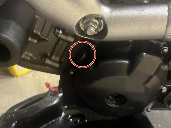

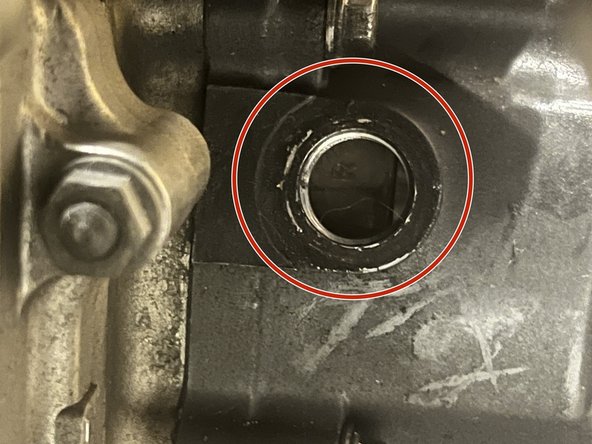

  21. 1999-2002 Suzuki SV650 Valve Inspection and Adjustment Replacement, Remove these two big screws: crwdns2935265:021crwdnd2935265:01crwdnd2935265:02crwdne2935265:0 1999-2002 Suzuki SV650 Valve Inspection and Adjustment Replacement, Remove these two big screws: crwdns2935265:021crwdnd2935265:02crwdnd2935265:02crwdne2935265:0
    • Unscrew this with a 10mm Allen Socket.
    • Unscrew the second screw with a 8 MM Allen Socket. We will be able to see if the bike is at TDC and put it on F or R depending on which one we are checking

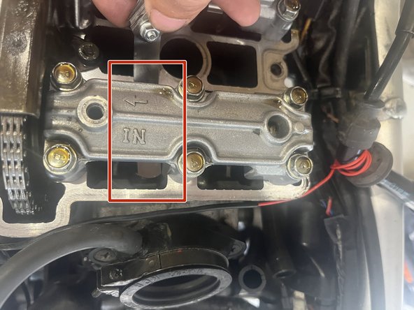

  23. 1999-2002 Suzuki SV650 Valve Inspection and Adjustment Replacement, Checking Rear Valves: crwdns2935265:023crwdnd2935265:01crwdnd2935265:03crwdne2935265:0 1999-2002 Suzuki SV650 Valve Inspection and Adjustment Replacement, Checking Rear Valves: crwdns2935265:023crwdnd2935265:02crwdnd2935265:03crwdne2935265:0 1999-2002 Suzuki SV650 Valve Inspection and Adjustment Replacement, Checking Rear Valves: crwdns2935265:023crwdnd2935265:03crwdnd2935265:03crwdne2935265:0
    • We are finally at the point of checking the rear valves. Now there are the intake and exhaust valves. The Intake has a tolerance of 0.10 and 0.20 and the exhaust is 0.20mm and 0.30mm. Keep the bike in neutral as well.
    • Stick the feeler gauge from the inside out underneath the valve. Try the biggest allowed tolerance and work yourself down or up to see when it finally tightens.
  24. 1999-2002 Suzuki SV650 Valve Inspection and Adjustment Replacement, Clearance?: crwdns2935265:024crwdnd2935265:01crwdnd2935265:01crwdne2935265:0
    • If you are within the tolerated clearance then congratulations, you have reached the end of this guide, lucky guy.
    • If not it really depends on if you need to do only the rear or also the front (or vice versa).. In that case, you're in for a long ride

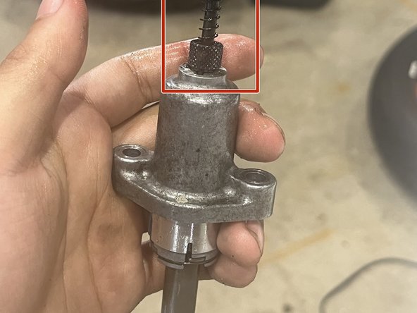

  25. 1999-2002 Suzuki SV650 Valve Inspection and Adjustment Replacement, Rewinding Tensioner: crwdns2935265:025crwdnd2935265:01crwdnd2935265:03crwdne2935265:0 1999-2002 Suzuki SV650 Valve Inspection and Adjustment Replacement, Rewinding Tensioner: crwdns2935265:025crwdnd2935265:02crwdnd2935265:03crwdne2935265:0 1999-2002 Suzuki SV650 Valve Inspection and Adjustment Replacement, Rewinding Tensioner: crwdns2935265:025crwdnd2935265:03crwdnd2935265:03crwdne2935265:0
    • We will now bring our attention to the rear cam chain tensioner. Use a 10mm Socket and remove the middle screw. Grab your expensinve little 80 dollar tool and insert it in the middle and rewind the tension.
    • Here is how that looks with a tensioner I had laying around.
    • I will not be doing the Front valve adjustment as I probably stripped the head of my tensioner, but the last picture shows the location of the front cam chain tensioner. The same method applies here

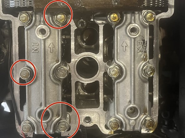

  27. 1999-2002 Suzuki SV650 Valve Inspection and Adjustment Replacement, Removing the valve covers: crwdns2935265:027crwdnd2935265:01crwdnd2935265:02crwdne2935265:0 1999-2002 Suzuki SV650 Valve Inspection and Adjustment Replacement, Removing the valve covers: crwdns2935265:027crwdnd2935265:02crwdnd2935265:02crwdne2935265:0
    • use a 10mm socket and remove the screws asshown on the pictures. This is to avoid too much tension on the cover. I have broken them before by not doing this (with installation, but its good practise to do it with removal as well) Do this for both covers
