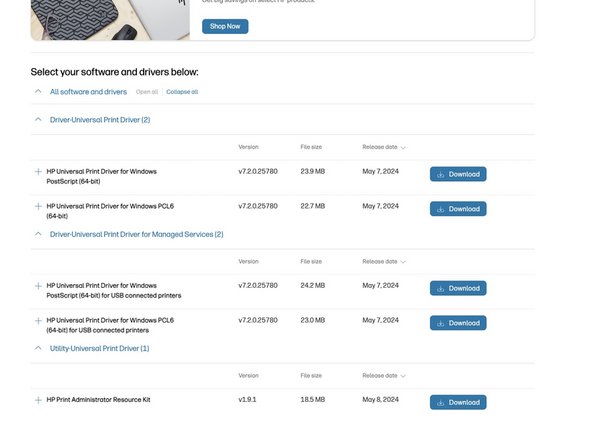

  3. (Windows) Installing a HP LaserJet Printer using the HP UPD, Download the HP UPD driver: crwdns2935265:03crwdnd2935265:01crwdnd2935265:02crwdne2935265:0 (Windows) Installing a HP LaserJet Printer using the HP UPD, Download the HP UPD driver: crwdns2935265:03crwdnd2935265:02crwdnd2935265:02crwdne2935265:0
    • I knew what my printer used in advance. Yours may have minor variations.
    • Once you know what print language(s) your printer supports, download the best one for your printer. The driver can be found on the HP website.

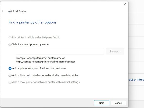

  6. (Windows) Installing a HP LaserJet Printer using the HP UPD, Dynamic Mode - adding a printer: crwdns2935265:06crwdnd2935265:01crwdnd2935265:03crwdne2935265:0 (Windows) Installing a HP LaserJet Printer using the HP UPD, Dynamic Mode - adding a printer: crwdns2935265:06crwdnd2935265:02crwdnd2935265:03crwdne2935265:0 (Windows) Installing a HP LaserJet Printer using the HP UPD, Dynamic Mode - adding a printer: crwdns2935265:06crwdnd2935265:03crwdnd2935265:03crwdne2935265:0
    • Select a file to print and select the HP Universal Printing PCL6 "printer". A box to select a printer will immediately pop on your screen.
    • Once the HP printer queue comes up, select Add a printer address or Search for printer addresses and enter the IP address setup on your printer, if you enter the IP address manually.
    • Manual IP entry only Enter the IP address and click Ok. The printer will now be added.

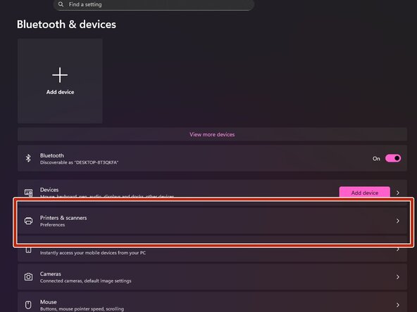

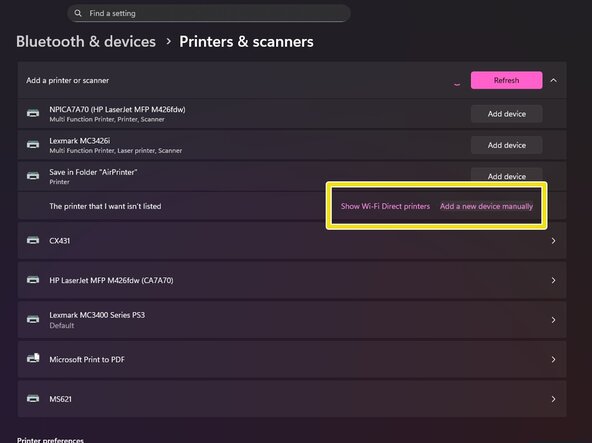

  8. (Windows) Installing a HP LaserJet Printer using the HP UPD, Windows 11 24H2+ - accessing manual setup (Control panel): crwdns2935265:08crwdnd2935265:01crwdnd2935265:03crwdne2935265:0 (Windows) Installing a HP LaserJet Printer using the HP UPD, Windows 11 24H2+ - accessing manual setup (Control panel): crwdns2935265:08crwdnd2935265:02crwdnd2935265:03crwdne2935265:0 (Windows) Installing a HP LaserJet Printer using the HP UPD, Windows 11 24H2+ - accessing manual setup (Control panel): crwdns2935265:08crwdnd2935265:03crwdnd2935265:03crwdne2935265:0
    • These steps are for Windows 11 24H2+ and legacy versions which you choose to use the control panel.

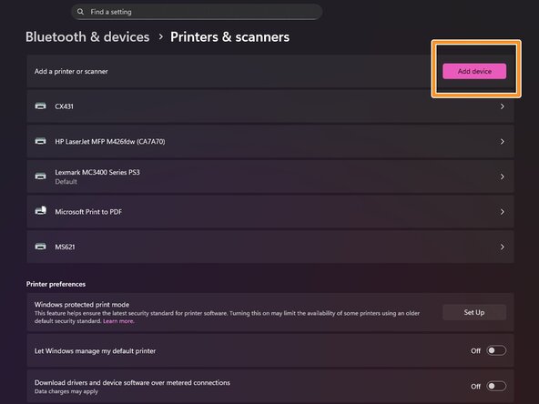

    • On the left side (not shown), click on Bluetooth & devices. Once this is done, click on Printers & scanners.
    • Click on Add device. Wait a few minutes and click on Add a new device manually.
    • Previous steps apply as they did in Win7 and older. Setup your legacy printer as normal.

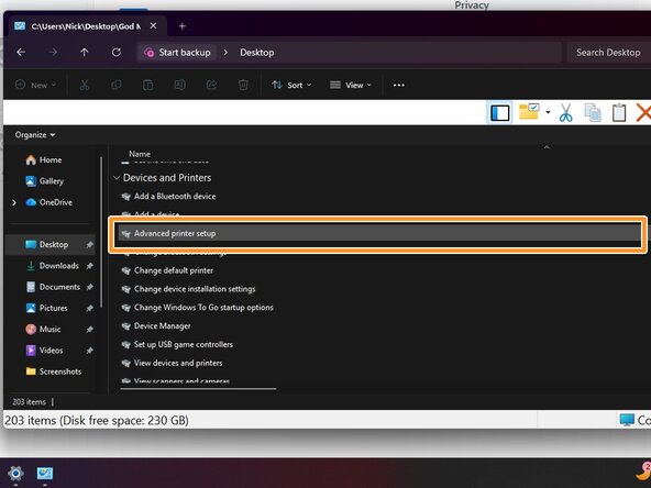

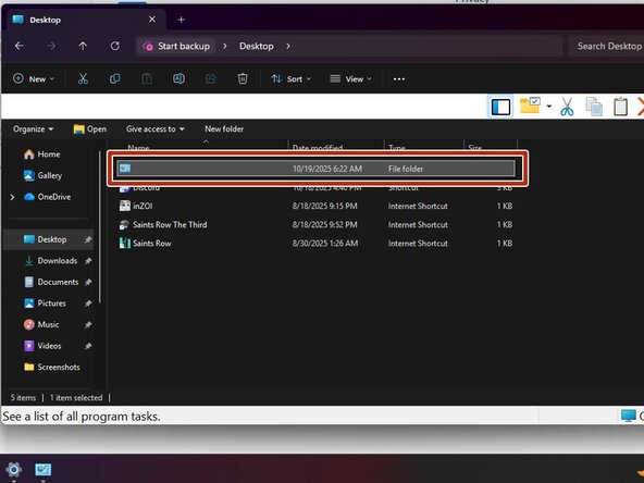

  9. (Windows) Installing a HP LaserJet Printer using the HP UPD, Windows 11 24H2+ - God Mode: crwdns2935265:09crwdnd2935265:01crwdnd2935265:03crwdne2935265:0 (Windows) Installing a HP LaserJet Printer using the HP UPD, Windows 11 24H2+ - God Mode: crwdns2935265:09crwdnd2935265:02crwdnd2935265:03crwdne2935265:0 (Windows) Installing a HP LaserJet Printer using the HP UPD, Windows 11 24H2+ - God Mode: crwdns2935265:09crwdnd2935265:03crwdnd2935265:03crwdne2935265:0
    • After setting up God Mode, click on the blank shortcut.

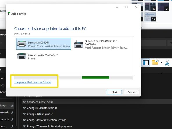

    • Scroll down to Devices and Printers and select Advanced printer setup.

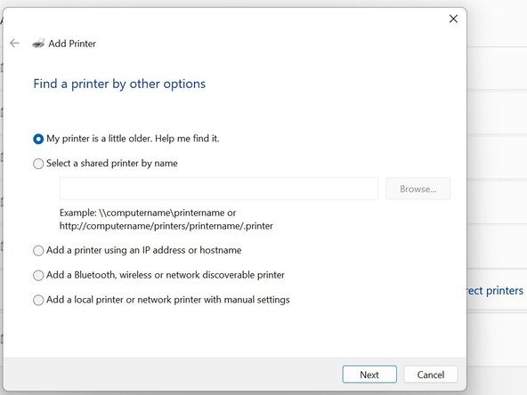

    • Select My printer isn't listed if needed - most super old models will require this, but some newer models might show up on the initial query.

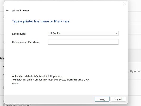

    • Click Add a Printer. If your printer uses USB, select Add a Local printer. For networked printers, select Add a Network, Wireless, or Bluetooth printer.
    • Allow your computer to populate the driver list. Find HP and then locate the driver that says HP Universal Printing (PCL6/PostScript). Select the driver and click Next.
