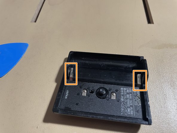

  3. (AAA) Cleaning battery leakage (Maxxum 5000/7000), Unscrew the cover: crwdns2935265:03crwdnd2935265:01crwdnd2935265:03crwdne2935265:0 (AAA) Cleaning battery leakage (Maxxum 5000/7000), Unscrew the cover: crwdns2935265:03crwdnd2935265:02crwdnd2935265:03crwdne2935265:0 (AAA) Cleaning battery leakage (Maxxum 5000/7000), Unscrew the cover: crwdns2935265:03crwdnd2935265:03crwdnd2935265:03crwdne2935265:0

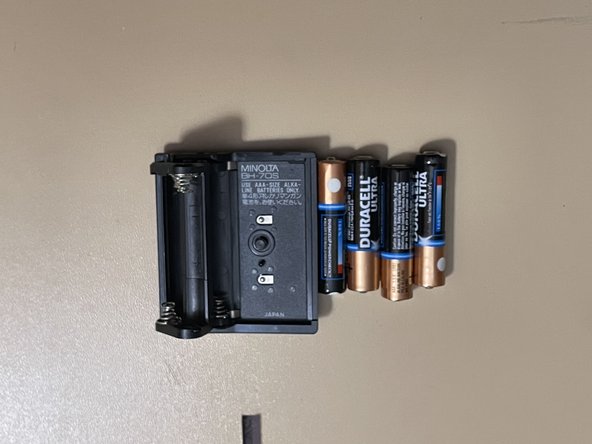

    • Unscrew the battery cover from the body. Remove the bad batteries.

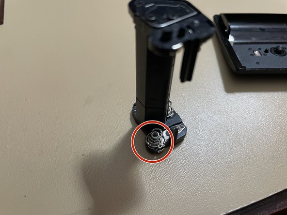

  4. (AAA) Cleaning battery leakage (Maxxum 5000/7000), Remove the battery retention clip: crwdns2935265:04crwdnd2935265:01crwdnd2935265:03crwdne2935265:0 (AAA) Cleaning battery leakage (Maxxum 5000/7000), Remove the battery retention clip: crwdns2935265:04crwdnd2935265:02crwdnd2935265:03crwdne2935265:0 (AAA) Cleaning battery leakage (Maxxum 5000/7000), Remove the battery retention clip: crwdns2935265:04crwdnd2935265:03crwdnd2935265:03crwdne2935265:0

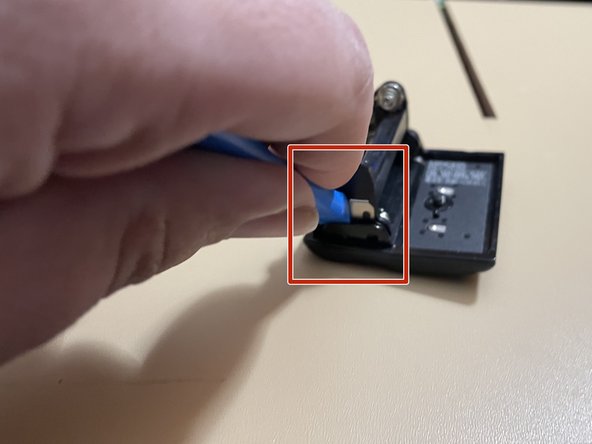

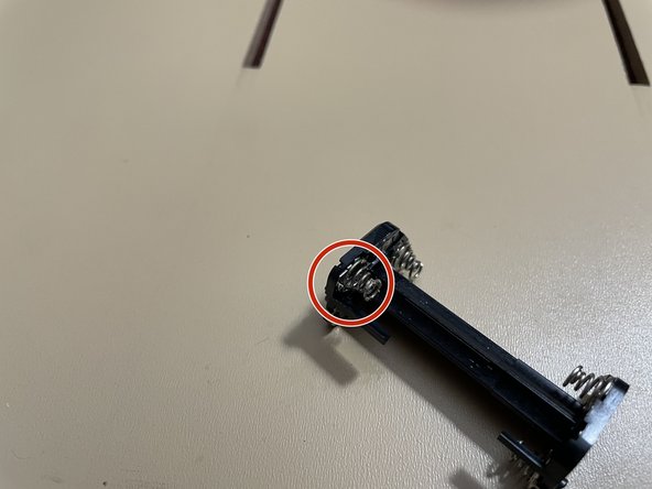

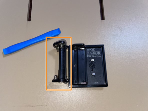

    • To thoroughly clean the AAA cover, you must disassemble it. You will not be able to fully clean it assembled.
    • Stick a screwdriver or pry tool in the side with one pin. DO NOT pry on the side with 2; it can break the second pin.

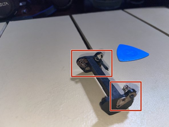

    • LIft up on the clip and remove it. This can be safely cleaned in a vinegar bath.

  6. (AAA) Cleaning battery leakage (Maxxum 5000/7000), Battery corrosion neutralization: crwdns2935265:06crwdnd2935265:01crwdnd2935265:02crwdne2935265:0 (AAA) Cleaning battery leakage (Maxxum 5000/7000), Battery corrosion neutralization: crwdns2935265:06crwdnd2935265:02crwdnd2935265:02crwdne2935265:0
    • If there is any stubborn alkaline on the screw plate, sand the affected tab down until you have a good connection and STOP. The tabs are VERY THIN.
    • With the battery holder disassembled, clean the clip by soaking it in vinegar.
    • If affected, clean the tabs on the screw cover with a toothbrush or Q-Tip.

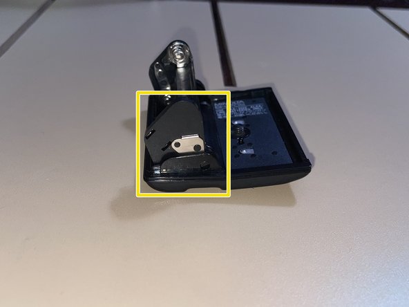

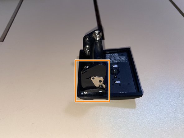

  7. (AAA) Cleaning battery leakage (Maxxum 5000/7000), Reassemble the cover: crwdns2935265:07crwdnd2935265:01crwdnd2935265:03crwdne2935265:0 (AAA) Cleaning battery leakage (Maxxum 5000/7000), Reassemble the cover: crwdns2935265:07crwdnd2935265:02crwdnd2935265:03crwdne2935265:0 (AAA) Cleaning battery leakage (Maxxum 5000/7000), Reassemble the cover: crwdns2935265:07crwdnd2935265:03crwdnd2935265:03crwdne2935265:0
    • Slide the side with 2 pins in FIRST, then let it rest.
    • Push down to lock the cover in place. Note: You may need to push the plastic on the screw plate back with a pry tool.
    • Put it in the closed position, and check if it opens correctly and accepts batteries.
