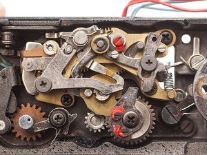

The operation of the camera, including the timing of the shutter speeds, is fully mechanical. The battery is only required for the light meter, but normal exposures can be made without any power. Consequently, most malfunctions are due to dirty or fouled mechanisms. Disassembling, cleaning and reassembling the affected area will resolve most issues with the camera. Occasionally, replacement parts will be needed, but the individual components are quite robust and most can be refurbished.
The general procedure for troubleshooting major faults and malfunctions is to disassemble the camera into its primary subassemblies and inspect each to see if it is functioning normally. For the Pentax MX, and many other 35mm SLRs, the major subassemblies and the functions they perform are as follows.

The most common issue is simply a jammed camera. The shutter won't fire and/or the film advance won't wind. The release sequence of a mechanical camera is quite complex and if any latch or lever is not functioning properly, it can result in an incomplete exposure cycle and a jammed camera. The high level solution is to disassemble the camera and inspect the different mechanical subassemblies until the root cause is identified. The most common areas to find issues are on the bottom of the camera and on the side of the mirror box. Disassembling and cleaning the mechanisms can return most jammed cameras to functionality.

  • Mirror box mechanism: This is a bit extra but the mechanisms on the side of the mirror box are the source of a lot of jammed cameras. Disassembly and cleaning can prevent future failures.
