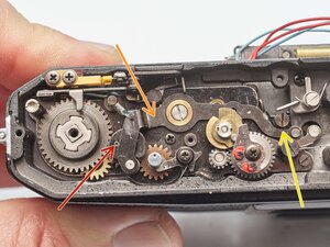

Opening curtain release
Transport gear latch
As the shutter button pushes down the release plate mentioned earlier, it also depresses the transport gear latch (red). This decouples the top gear from the bottom gear and allows the top gear to spin freely as the opening curtain is traveling across the frame.
Opening curtain latch
When the mirror completes its travel to the top of the mirror box a lever will strike the opening curtain latch (red), releasing the opening curtain and beginning the exposure.
Both the opening curtain latch and the transport gear latch must be released for the opening curtain to start the exposure.
Opening curtain travel
The opening wind gear (red) begins in the position shown on the left, makes almost one full counter-clockwise revolution, and ends in the position on the right. It's caught by the curtain break (orange), which prevents the curtain from bouncing off the end stop and back into the frame. If curtain bounce is detected, or if the wind gear is not reaching the end stop, the curtain break can be adjusted by turning the slotted screw (yellow), and changing the amount of engagement.
