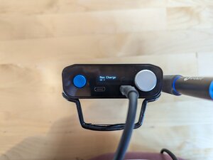

The Portable Power Station is the power source and control interface of the FixHub product line, and can be used with the Smart Soldering Iron. The Power Station is part of the Portable Soldering Station which was released on October 15th, 2024.
The Portable Power Station was designed to make soldering location-independent while delivering the capabilities of a wall-powered station. It has dual USB-C ports with a 100‑watt combined output and a battery capacity of 55 watt‑hours, providing up to 8 hours of continuous soldering on a full charge.
The power station can be used to charge multiple devices from its two front USB-C ports, such as a laptop, phone, or handheld gaming device. Its single rear USB-C port accepts up to 45W for charging the unit, which goes from 0-100 in approximately 2 hours using the iFixit GaN Fast Charger.
