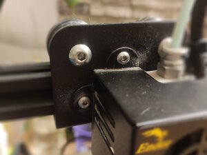

The Ender 3 Pro has an extruder (where the material comes out), a robotic mechanism that moves the extruder as necessary, a print bed, as well as additional components. These components are attached to a rectangular frame and printer base. The Ender 3 Pro has the Ender logo located on the printing base.
