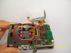

Ben, I just finished one of those cameras and I did not have to use a plastic opening tool. For most of it, my fingernails were good enough:) Follow this guideright up to step 17. Remove the 3 screws and the cable from the connector. That is your CCD. Hope this helps, good luck
Thanks for your sharing and especially the picture. It helps.

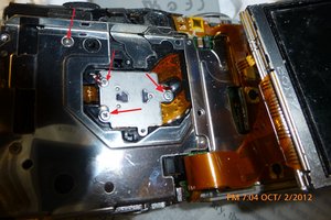

Old, I have troubles opening up the screws at those red arrows in the attached picture. It is too small and very very tight. My screwdriver may be too big and too weak for them. I believe I must open those screws and nearby cable connectors in order to change CCD. See if you have any ideas. Thanks...
Ben, the screw heads still look in good shape. I would suggest a new screwdriver set. This is something you will need a Phillips with good sharp edges. A good jewelers set will work. Some downward pressure and a quick left turn should loosen the screws. Yes, those are the ones to remove....
Old, thanks for your suggestions. I successfully removed 2 screws out of 3 using a new set of #000 screwdrivers. The remaining one on the left top corner of the silver cover plate is very tight. That is a big trouble....
I am afraid that that screw is stripped when I was trying to remove it using other bigger screwdrivers. If that is stripped, do you have any suggestions on how to take it out?
Right next to the screws on the top of CCD silver cover plate, it appears that there are some material like glue. Do you need to remove it before changing CCD?
I also have a hard time to remove the cables from connectors. Can you give me hints on how to open that up? Hard to find anything that I can move in that connector.. :(
Ben as for the wiring, the main connector has a clip that you move upward tho release the cable. Take a Look at at thisguide, step 16. To remove the stuck screw you may try a slightly bigger screwdriver, tap it onto the screw which maintains a downward pressure while turning the screwdriver. I sometimes use a relative heavy pairs of pliers to tab the back of the screwdriver into the screw head while turning it. Besides that, you could use some small set of sidecutters and see if there is enough room to get a good grip on the screw head to turn it out. If not, it;s Dremel time:-)
