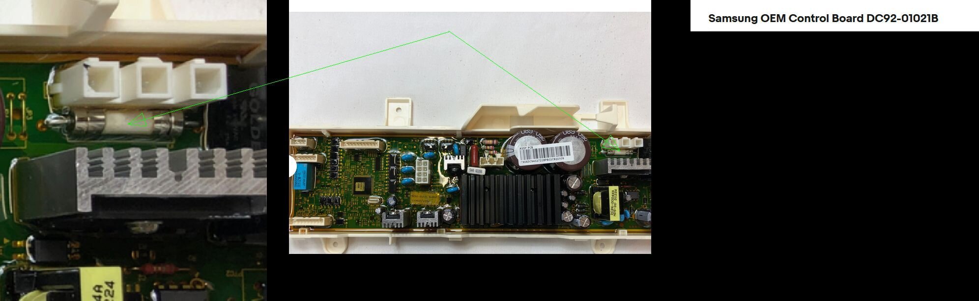

My washer will not come on i did a hard reset and still nothing i plugged a different object in to the wall outlet and there is electricity there but the machine will not come on
Hi @gaylingoodson
If there's power at the wall outlet but none showing on the washer it could be a faulty power cord or a blown fuse on the control board in the washer.
Below is an image showing the location of the fuse on the control board.
Disconnect the power to the washer and then access the board and use a DMM's (digital multimeter) Ohmmeter function to see if the fuse is OK i.e. meter should read 0.00 Ohms.
If it reads OL or open circuit then the fuse has blown and would need to be replaced.
Unfortunately I cannot zoom in far enough on any online images of the board I found to find out its rating but fuses generally have their rating stamped on the end caps of the fuse.
