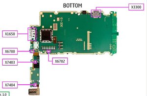

how do i get the micro usb on my nokia n8 working again, i cant connect to my laptop or charge it now via my car charger, when i do connect it and select mass storage, i get nothing, any help would be great, i have tried different usb cables, car chargers and other peoples laptops and it does not connect so its definatly the phone
Hello, I have a similar problem, no charging, but the usb socket is clean, maybe the power supply is damaged. Are there any programs that would help determine the location of the damage?
carl, it is a standard micro USB port. You should get it at places like Mouser.com or digikey.com. There are of course other places like this. It all depends on your geographical location. The port is soldered onto the PCB and listed a X3300 and the part number is 5400056 Hope this helps, good luck.
Before spending money you could try this:
A common problem with micro USB is the build up of dust in the socket. Every time you insert the plug, dust coming from your pocket is pushed in, which gradually fills the socket. The result is loss of connectivity.
The good news is that it is very easy to clean the socket. First remove the battery in order to avoid any short circuiting during the procedure. Then take a needle and pick out all dust and dirt from the USB socket. You'll be amazed how much will come out. A magnifying glass may be helpful. Once the socket is clean, reinstall the battery and cover.
