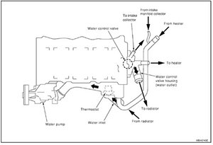

Where is cooling system thermostat located?
Both fans are running in a/c mode yet engine is overheating is this a themostat problem?
cjsollicito, it is possible, but it is only one component of the cooling system that can cause this. Here are a few others:

I would say start with your coolant first and work your way down the trouble shooting list. The attached images show you the location of the thermostat.
