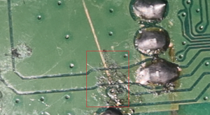

I had stick drift on one of my Ds4 v2 contoller (JDM-055), i decided to replace it with hall effect sticks, when i tried to desolder 1 pin had trouble coming loose, 1 of the big pins from module, i kept reapplying solder and desoldering with pump, i finally tried to pry the other loose pins, they all came loose except this one last pin, i treid to heat it again, it came off, but the circular ring on the pcb which touches the vias came off during last heating, i didnt see any traces from this pin, so i continued with replacement, replaced everything, but accidentally when adjusting my pcb holder, the plastic which has the battery pin connector came loose, it was still connected to pcb on the soldered part, but the plastic side kinda came loose, i tried applying hot glue and secured it, assembled everything and tried turning on, i got no power, so i connected back panel too to check power while wired, still no power, controller appears dead. Is it because of the loose battery pin or the burnt pcb pad
@paplo1634 before you do anything else, there's a serious issue with your motherboard. I found solder connecting the pins of this chip. Highlighted in this picture:
You probably heated the motherboard for too long and that's what's causing the controller to not power on. Remove it using solder wick and see if it works.

Omg i didnt even notice it, i used wick and tried turning on with battery it didnt turn on, i tried with wired, it works but kept saying low battery ds4 disconnected, that battery connector is gone i guess, but it works as wired, i dont mind it 😁, Thank you so much, i was sad from yesterday this was my first time doing this, i dont know if i can fix the battery connector, ill better take it to professionals, I have one other controller which lost a smd resistor ill post it later, Thanks everyone

I just forgot about the scratch i made when i tried to push that last pin which was stuck, could this scratch have damaged the trace?, have attached images for it and the battery conenctor too
Okay, the solder pad is damaged and need to be fixed. Also the traces look damaged and probably need to be fixed as well. Where the battery connector is, those pads and nearby trace do look a little damaged as well. This is probably the case why the controller isn't turning on.... So you do need to fix the traces and pad(s) to get it working again. Replacing the motherboard is another option as well.
I found some pins connected by solder in the 3rd picture, that's probably why the controller's not turning on. If he can fix that then a new motherboard won't be necessary.
