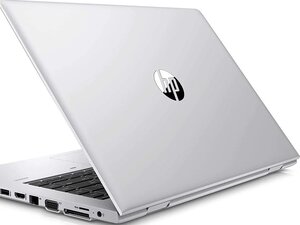

The HP ProBook 640 G4 or ProBook 640 G4 Notebook is a laptop first released in the summer of 2018 as part of the fourth generation of HP ProBooks. The HP ProBook 640 G4 is a mid-price business laptop with a 14-inch screen.
Laptop screen is blinking
How to repair laptop screen blinking
Hi!
Please try connecting an external monitor to your laptop. If the screen is appearing as normal, it is more likely to be a hardware failure of some kind, that the screen module is broken, loose or damaged cables etc., and the faulty component would need to be repaired or replaced.
If your problem appears on an external monitor too, it is more likely to be a software problem, it can be faulty driver or a GPU problem. Try making sure that you have all your firmware/drivers/BIOS up to date and try making a clean install of your GPU drivers. If your running windows 11 you can on-top of this also go to Settings > Windows Update > Advanced Options > Recovery and then select "Fix problems using Windows Update" by pressing Reinstall now.
