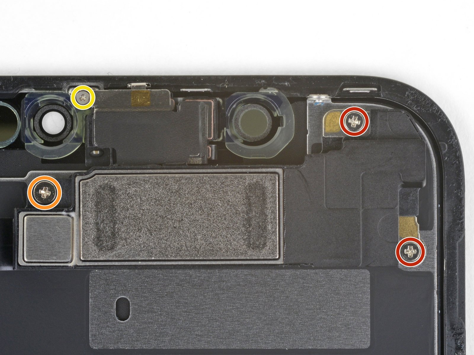

Hi, I purchased the iFixit MAKO driver set. I am trying to replace the earphone speaker on an iPhone XR. The Y000 bit is ok for 3 out of 4 screws that hold the assembly but the smallest screw does not seem to have a proper bit for in this set ? Any hints ?
Hey there! I am guessing you got a little mixed up, there are actually 3 philips screws on the earpiece speaker, and then 1 Y screw
The yellow one is the Y000
If you are having issue with this screw, it is a completely different bit than the other 3
The red one is the one that you would use. Below it is the normal 00 or 000. you want to use the Y000 or Y00
