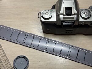

I replaced that pcb component,but these gaps are not stable.
I replaced that pcb component,but these gaps are not stable. Sometimes wide sometimes overlap.Do you have any solutions about this problem
The marked film bars appears to be a failing film drive where the expected image aperture is not consistent within the film. This is a gear drive with a clutch within the film advance lever which turns the sprocket drive.
