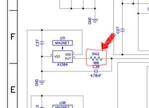

Good day, everyone. I have an Xbox One controller whose Lt button is always pressed on. After disassembling it, I noticed that one of the resistors connecting the magnet to the LT button was missing.
The problem comes with the replacements, I have an PDP xbox controller motherboard with a lot of resistances, but I encountered that most of them are lower (68 - 70 ohms) or higher (150 ohms) capacity than the original (100 ohms) according to the schematic. I have enough soldering skills to do the job, but I was wondering if there will be any serious problems if I replace the resistance with a lower or higher one. Will I have more problems with it? Could it destroy my controller? I made this post because I could buy one on AliExpress, but I want to speed up the process without mentioning it to the professionals first.
I hope you can all help me. I will attach the exact schematic and the part of the resistance for more details. If you have any other information about my problem, such as the exact resistance I need or if there is something else on the controller causing the LT button to be pressed all the time, I would be very grateful. Thank you and have a good day everyone.
