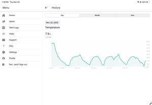

Have LRFCS25D3 acting very weird.
Freezer temp fluctuates from 0 to 20 degrees every 6-8 hours, while frig seems to stay in 38-45 range during same time.
Ran test with button on PCB board, evaporator fan runs during test, and have changed thermistor, but still constantly fluctuating.
Any ideas?
Possibly compressor relay?
Any advice appreciated.
Update (11/20/25)
[image|3863983]

How are you measuring the temperature variations from 0° to 20°?
If by some sort of temperature logging device are these fluctuations occurring overnight?
My thoughts are that either it's a faulty door switch signalling that the door is open when it isn't or it is a control board problem.
I am measuring with. Mocreo temp sensor and am trying to figure how to,post screen grab of the graph
