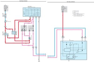

Rear window wiper not working
The rear window wiper doesn’t move, it spills water, but doesn’t wipe
Hi @mohammadba94877
Check if the the rear window wiper fuse in the instrument panel fuse box is OK.
The fuse number is different for different variants of the RAV4 e.g. in the EU it is fuse #3, in the USA it is fuse #20, in other areas it is fuse #4.
Consult the owner manual or the fuse layout diagram in the fuse box lid to find which fuse is used in your model.
If the fuse is OK then check if the rear window wiper motor is OK.
Here's video that may help.
If the motor is OK it could be a problem with the multifunction switch on the steering wheel or the wiring from the switch to the wiper motor.
Here's an image from the 2006-2012 RAV4 repair manual, showing the wiring diagram for the rear window wiper.
(click on image)
