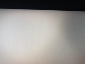

LG 43UM7100PLB, horizontal Lines after FIXING with "tape method"
Hi, my tv suddenly stopped working after roughly 4 years, but backlight was still working. After watching countless youtube videos i taped approximatly first 14 pins on my LEFT connector and it works now but! Now i have horizontal lines on my TV.
. I've figured (i hope correctly) that pins on my connector are:
  1. CLK1
  2. CLK2
  3. CLK3
  4. CLK4
  5. CLK5
  6. CLK6
  7. IDK
  8. IDK
  9. IDK
  10. IDK
  11. GND
  12. ODD
  13. EVEN
  14. IDK
Now first i will post top left corner.

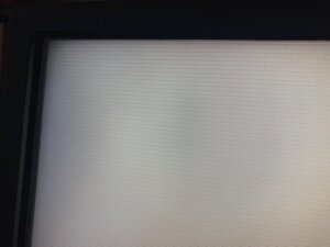

and now top right corner.
Left side is the bad. And right side was okay.
My question is: Will it be posiible to fix those lines or the PANEL is already somehow broken and this is best possible fix i could get. Thanks everyone for replying. Love ya <3
@malejvelkej very seldom that you will need to tape of 14 consecutive pins. You may just be taping off a needed data line. Try no more than 4 pins at a time. It's a bit of a guessing game and it may not work, but like I said, 14 pins is a lot.
it will probably be 1 of the clock lines, only tape them and then uncover 1 at a time until the issue starts again and then you need to cover the pin causing the issue
