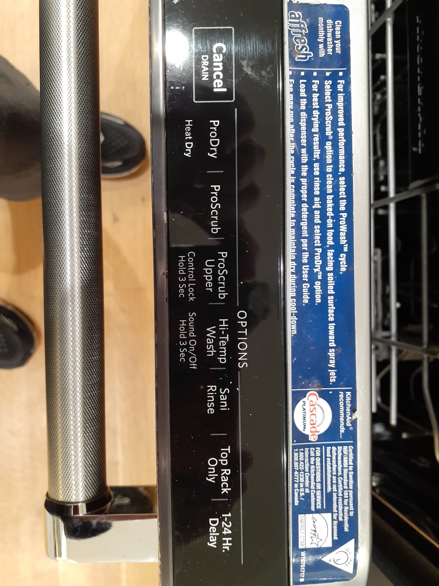

20251111_1049481515×2019 520 KB

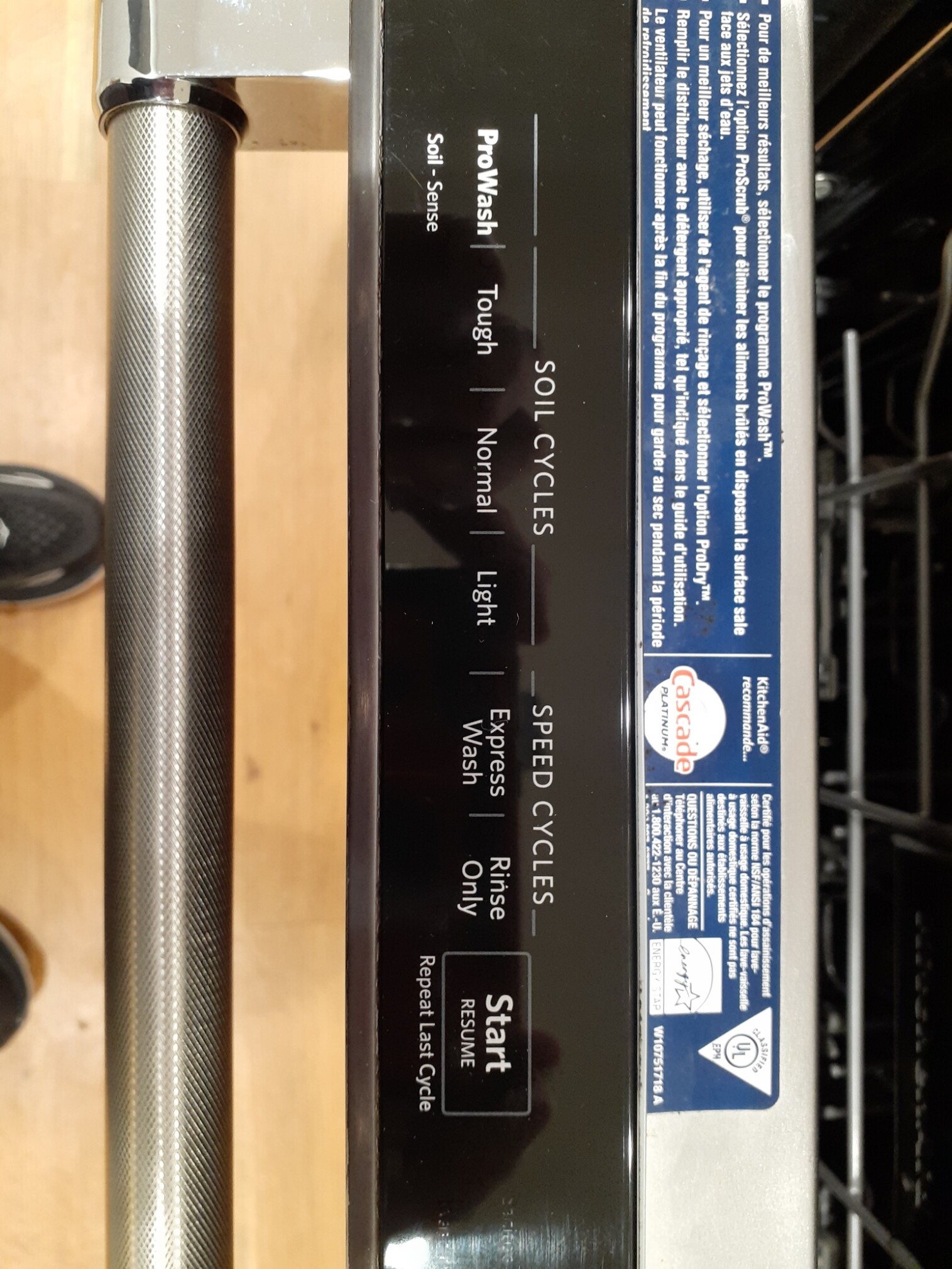

20251111_1049581482×1976 584 KB

Washer will not heat water. I just replaced the element & high-temp thermostat, but I don’t think they were bad, per resistance readings. I tried a cycle after replacing the two components, still no hot water. I physically touch the heating element during the wash cycle and it was cold.
I have read about resetting the cpu with a sequence of button selections, but none of the descriptions match my keyboard.
I cut the power off to the unit for a few days, hoping that would reset the control board and it would magically fix itself. No luck.
Which button selections do I need to press to enter diagnostic/re-set? What else could cause no-heat besides the control board?
