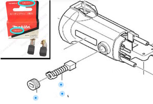

The Makita 9524NB is a 4-1/2 inch angle grinder with a 5 AMP motor, designed for grinding, cutting, and sanding applications, featuring a top-located switch and small circumference barrel grip. It has labyrinth construction to protect the motor and bearings, a shaft lock for easy wheel changes, and a side handle that can be installed on either side of the tool.
How to change carbon
The carbon brush is model CB-411
example product : https://www.aliexpress.com/item/10050020...
Removal of the cap is identical to this portion of this video : https://youtu.be/LyA82zDoeDk?t=87 <-- note the time, at 1:28 you will see the technique.
