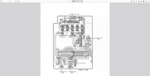

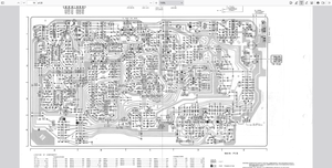

Hi everybody, My AKAI HX-M459W separate was working other than needed to change belts ,did so and when I tried it the sound started to break up and then stopped all together so everything else working but no sound .have checked the wires and see nothing broken so where would I start to check what has gone wrong Thank you for any info
PS: should have said its a double Tape Cassette player / recorder, have the service diagrams for you to look at

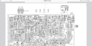

Check the connection between the J103 connector on the front board pcb and where it connects to on the main board pcb.
The VR102 and VR202 volume controls are on the front pcb so if the connection is broken there may not be any sound output.
Thanks jayeff have checked connections and all good the VR102 and VR202 is record level and cleaned the sliding bars can't get to slider its self but have sprayed contact cleaner is the best I can do with the slider
