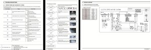

Hi @ahraitch
Here are some images taken from the service manual for your model, that may help to find out what's wrong.
(click on images)
