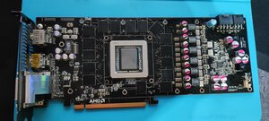

Ati Radeon R9 290 Sapphire repair
Hi, I have an old Ati Radeon R9 290 Sapphire and after I install a custom cooler a Ferrite chip was blown, searching the net I find it's a common issue to Sapphire gpu's and a B200 Ferrite chip. Sapphire respond that the B200 is actually an FBMJ2125HS420-T PSP FERRITE BEAD 42R 4A EIA. I want to order the chip from Ali express ******Can someone help me by indicate me to the right one or a compatible one? thnks.
Is there a reason you'd like to order from AliExpress? It will likely be easier to order this from a dedicated electronic components vendor. I found this exact part listed at both mouser and digikey, which are known reputable here in the US, but there are likely vendors of this that are local to wherever you are. I didn't actually see any on aliexpress that were an exact match, only ones that are a higher resistance.
Really if this is your part, the key things I would look for is a 42 ohm ferrite bead in an 0805 package the exact part is rated for fairly high current (4Amps).
Links for digikey and mouser.
Thnks for the EU link! Yes this is the item from the links you posted, I have found the first link in a forum from digikey US but I wanted a shop in EU or Ali. Thank you very much.
Well from the EU store they charge 22$ only for shipping so I'll look at Ali Express or ebay then...
